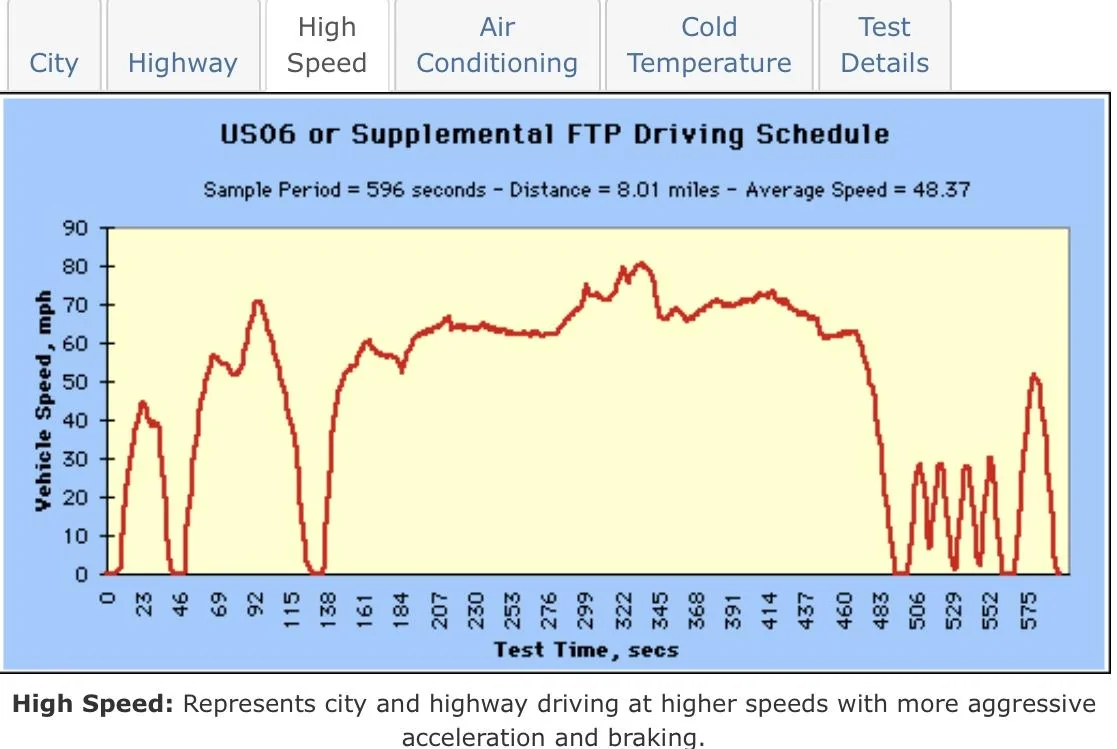

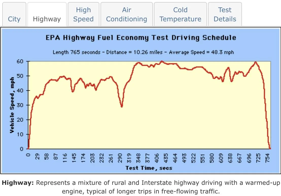

My apologies for the following rant……
(I am no expert, just a pragmatic reader)
What I’m (not) liking are some of the recent video reviewers that add a lot of their anecdotal comments complaining about how they’re not getting 300-320 miles of range when driving 70-75 mph...sorta like doing their own trolling out of one side of their face while saying how great the truck is out the other. This is followed by viewer comments chiming in agreeing with the mileage complaints…
What we’re they all, especially the testers, expecting? The EPA highway e-power-use rate is 63 MPGe using an indoor lab test, the highway portion which is nowhere near 70 mph, just roughly 1/2 of the High Speed Supplemental test
https://www.fueleconomy.gov/feg/fe_test_schedules.shtml
Ford F-150 Lightning First quick trip in my Lightning Platinum got a lot of attention 327083DD-791E-4184-8C58-F0C114D396F6
Ford F-150 Lightning First quick trip in my Lightning Platinum got a lot of attention EC7D9DD0-F07F-4C18-A5E9-AD341A8D102E
EPA Estimated Highway MPGe - 63: 63 mi/33.7kWh = 1.8694362018 mi/kWh
Most of what I’ve been seeing from real world driver experiences shared on this forum are “burn” rates between 1.6-1.9 mi/kWh, so the EPA test estimate is fairly close.
My issue is the blogger’s driving 70-75 mph (or greater) test cycles, while they’re complaining it doesn’t meet their ”range expectations“ of 300-320 miles (I.e., EPA est.)...They are driving like people are driving (which is ok), not as the EPA tests!
I welcome the “real world” data the testers and bloggers are generating and sharing…it is helping to ground us on what to realistically expect from the use of our vehicles.
What I’m growing weary of are the complaints that we’re not seeing/hitting the EPA estimates during sustained 70-75 mph drives…it is a false expectation, unless we choose to “drive” the same cycle as the EPA Dyno test, which many do not…
It is a free country, and it is about choice on the manner you wish to drive, provided you don’t kill or injure someone else (or damage their property) in the process?. It’s ok to wish Ford‘s design would provide more, but they didn lie or misrepresent the mileage. However, in being disappointed (if you are), we should keep our expectations about the mileage/range of this truck realistic……
