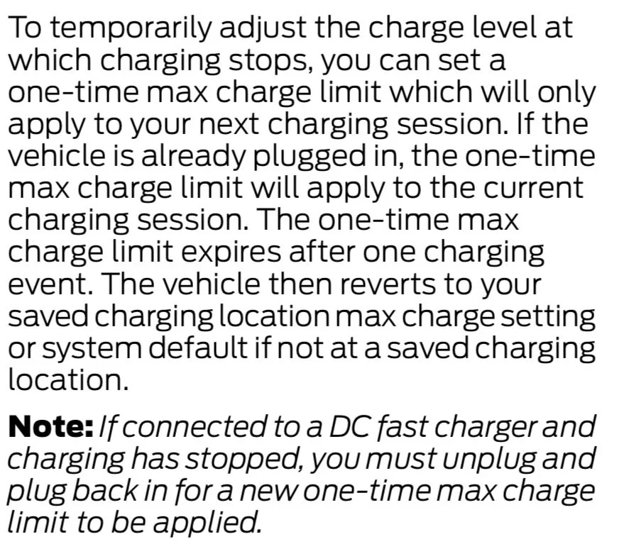

The only setting you can make to control DCFC is the one-time charge limit.
See the manual:

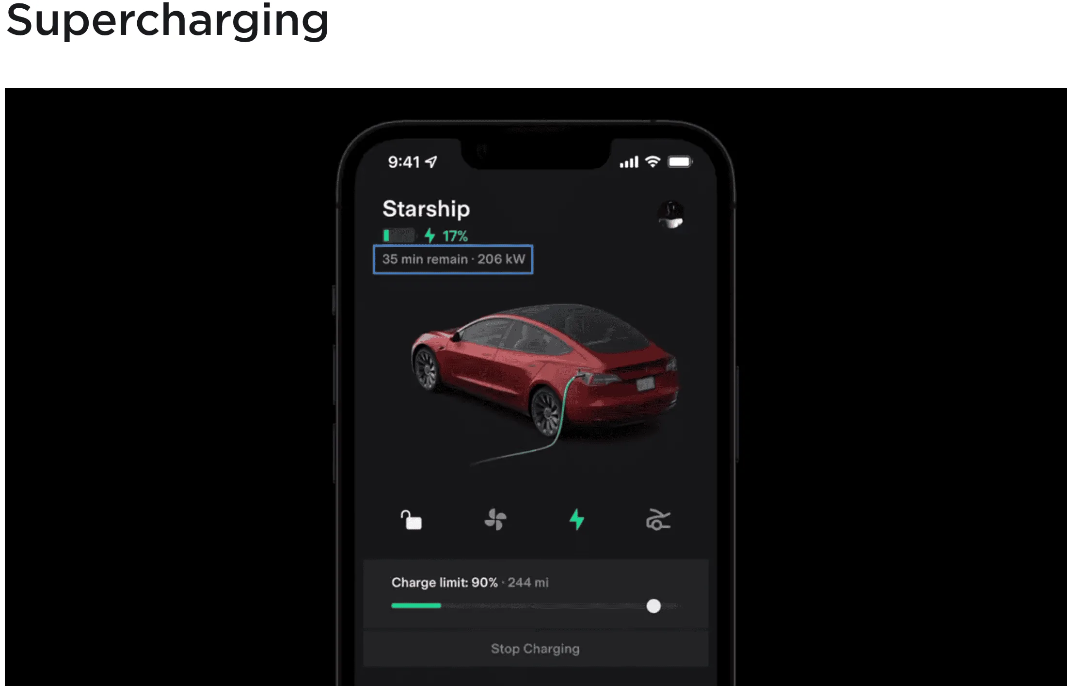

It was way easier to do on a Tesla, IIRC...
Ford F-150 Lightning First long trip in the Lightning Screenshot 2023-06-09 at 3.03.33 PM
See the manual:
And unfortunately many times this setting doesn't work and it still stops at 90%

Edit….the instructions for usin a one-time charge limit states that there is a “system default” but doesn’t tell us what it it:
Ford F-150 Lightning First long trip in the Lightning IMG_0528

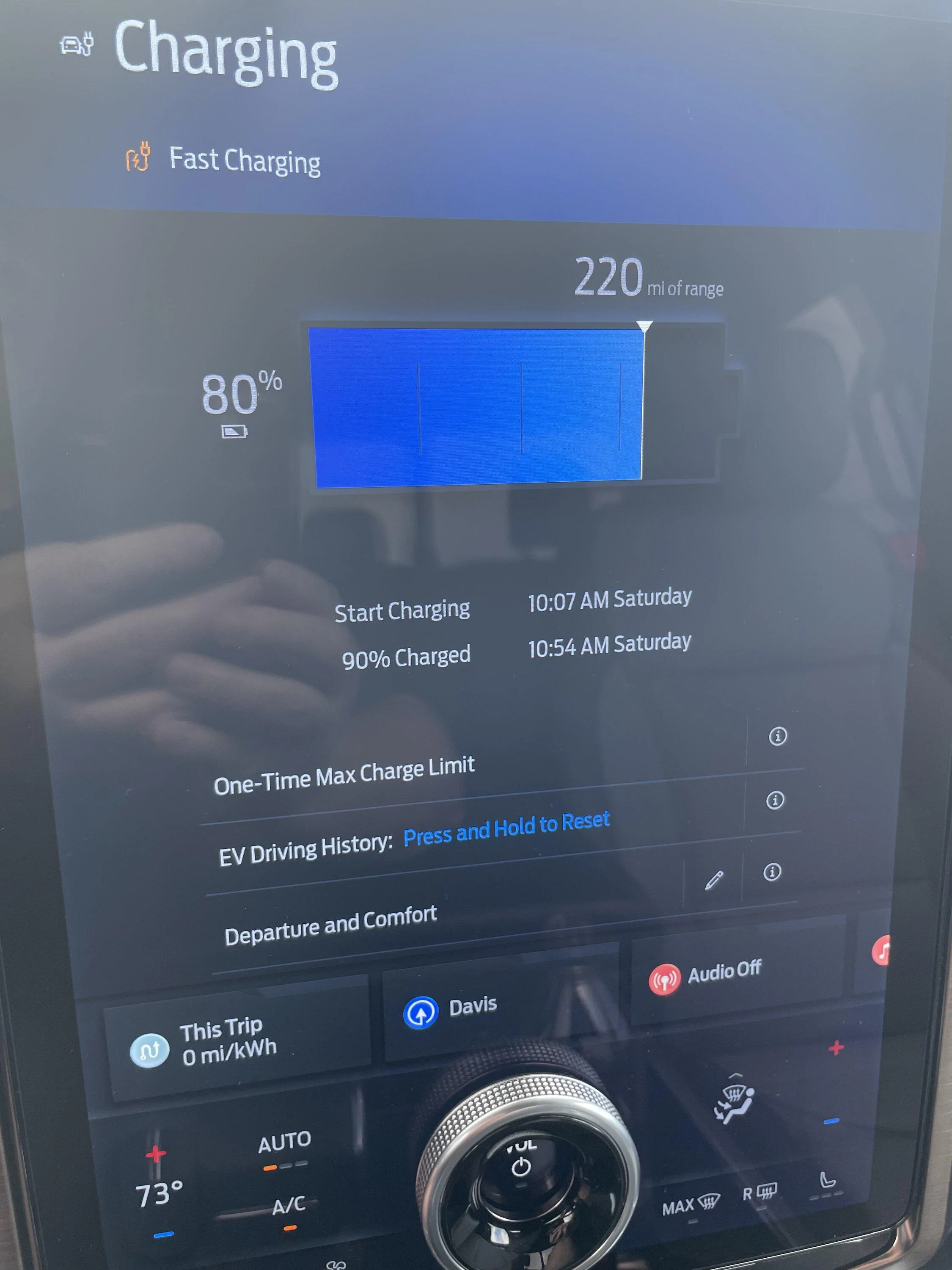

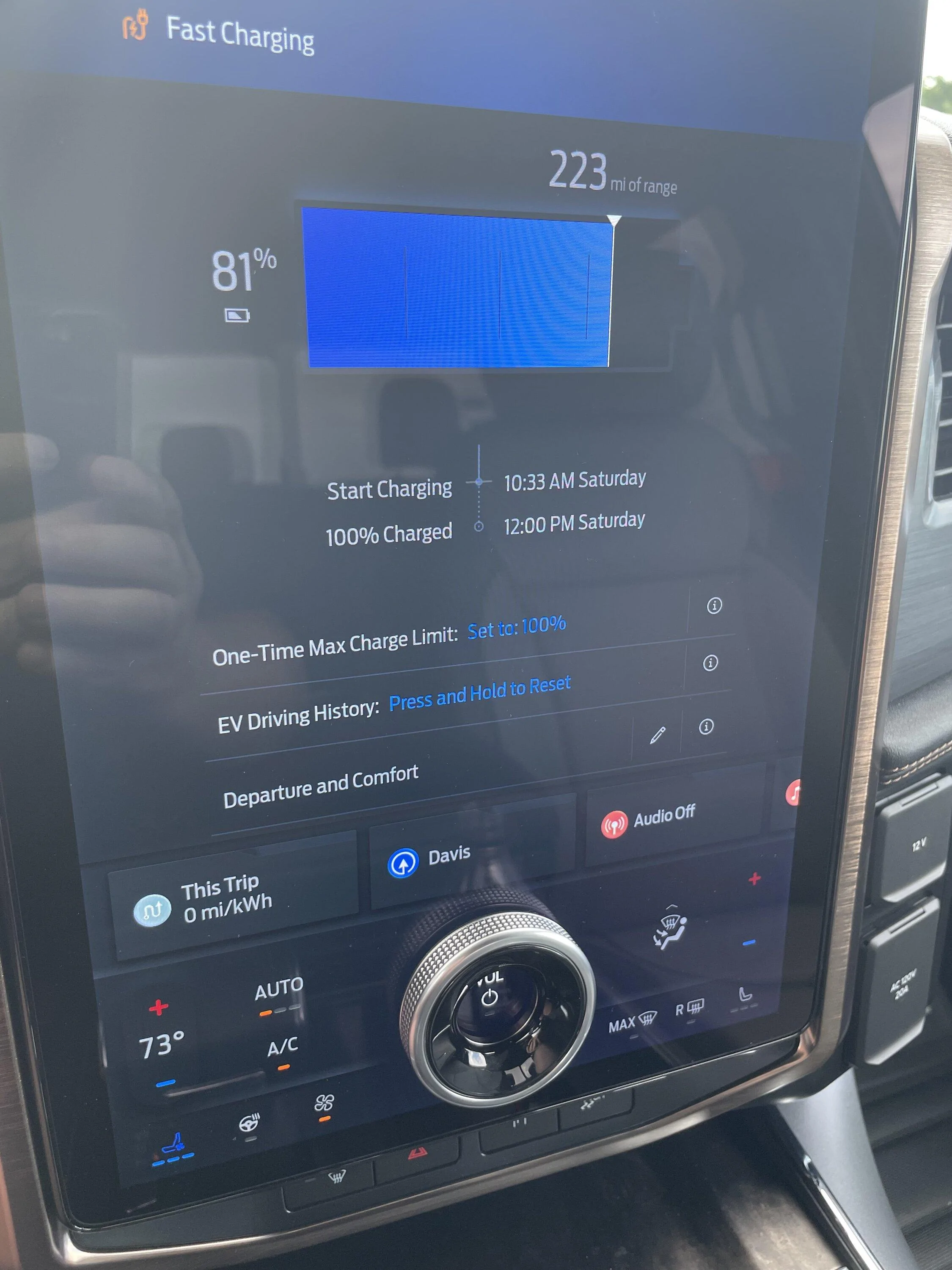

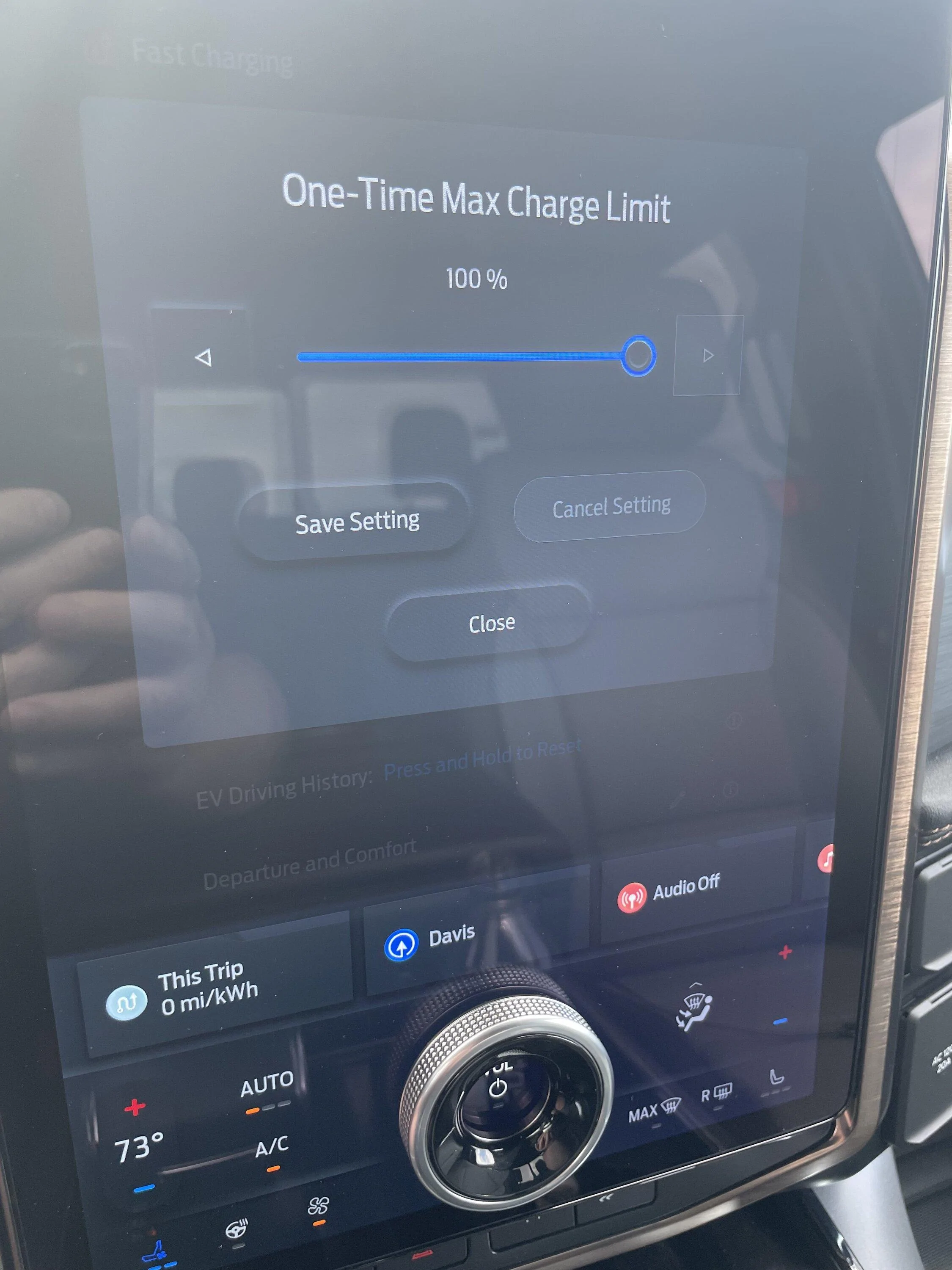

I didn't poke around long in the app, but didn't see a quick way to override, but in the GUI you can definitely override the standard 90% DCFC - touch it, select your max, and save. You can override for that session of DCFC charging.
Set at 90%

Set at 100%
