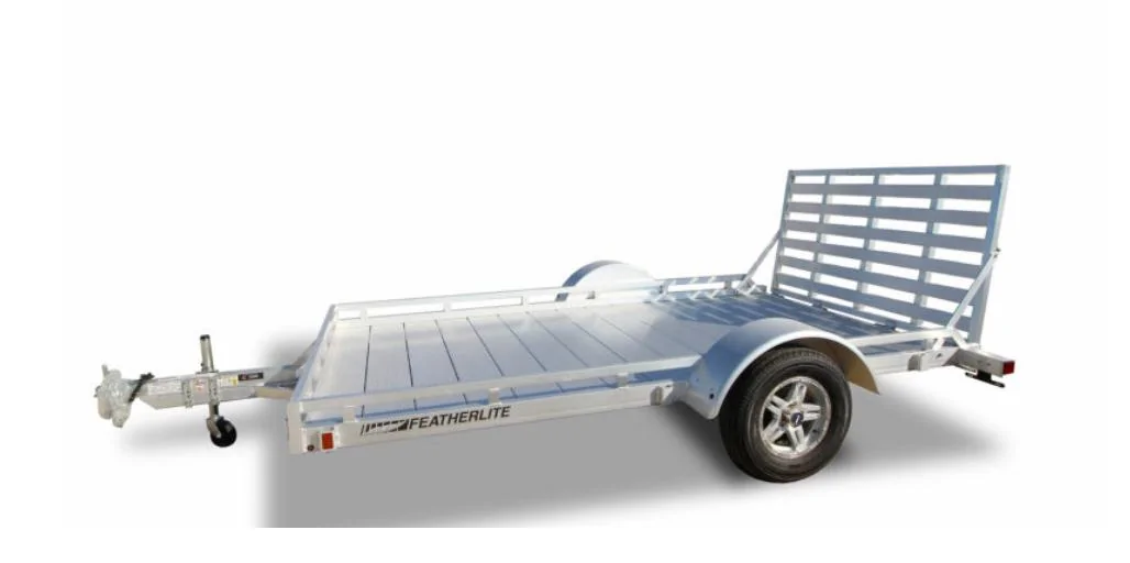

Did the trailer have a big expanded metal ramp sticking up?

Yes, it is equipped with a ramp. Here is a sample image…

That ramp creates a big part of the aerodynamic challenge. Even though it's slotted (which will help) it's going to create a ton of drag at hwy speeds.
I'd love for someone a lot smarter than me to look at a bunch of different trailers to identify their aero properties. Never thought that would be an issue I'd care about, but EVs continue to create new curiosities!
