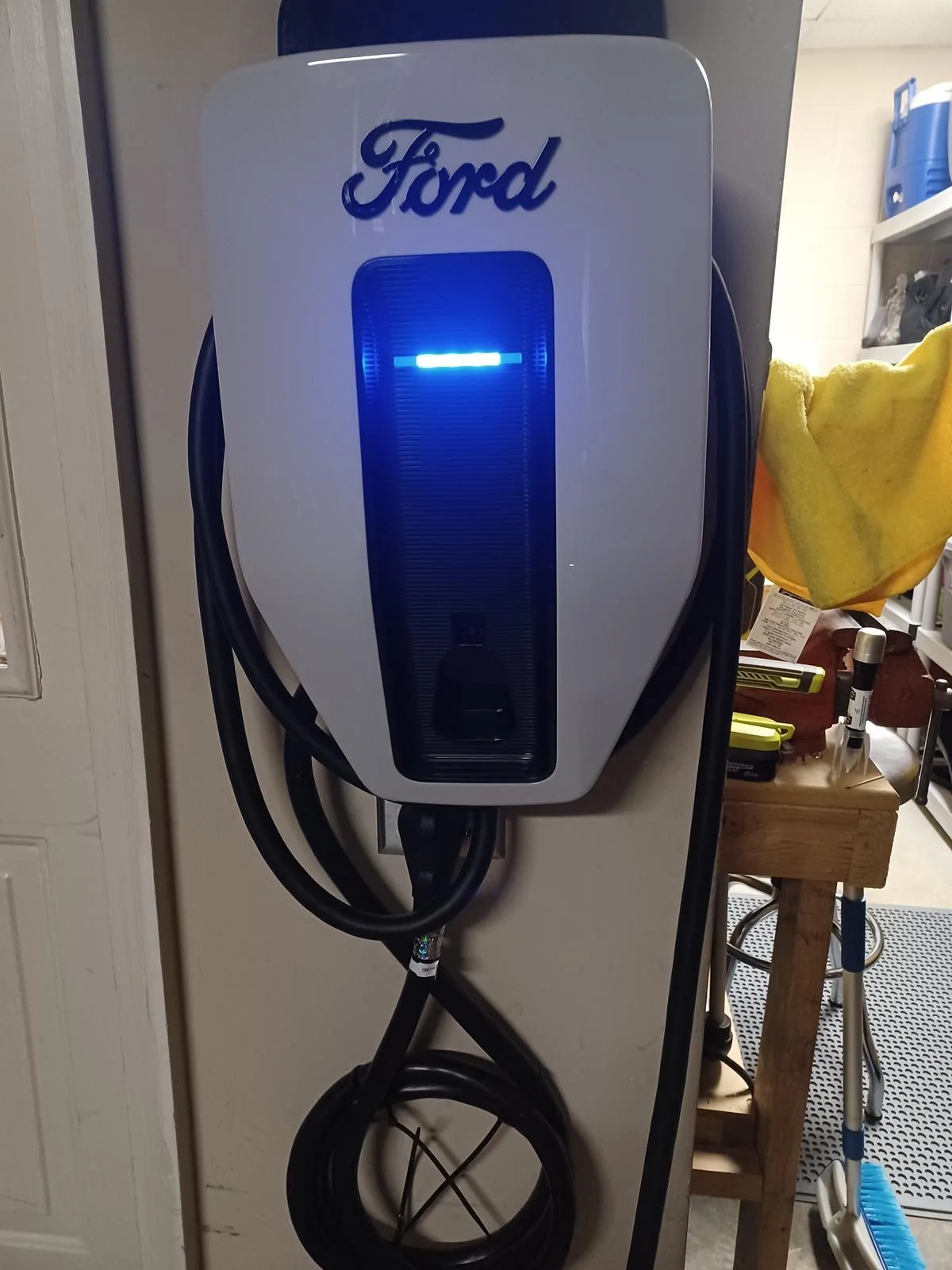

My mistake when I set up my electrical needs in 2021 with the Mach-e was not getting the 100 amp circuit. I had my same electrician come out last November but the cost for a 100amp was over $5k with new code requirements for sub-panel and the length of wire needed.
I instead bought an RV plug and wired in while also reducing the charge rate. Yes it isn't much faster then a portable charger but total cost was $30 and if we move I can take with me and maybe setup for 80 at a future house.
All that said I'm perfectly happy with the charger and have had no real need to recover any faster. With SC Tesla opening, once I have my adapter I can easily fast charge to 90% if needed now.
