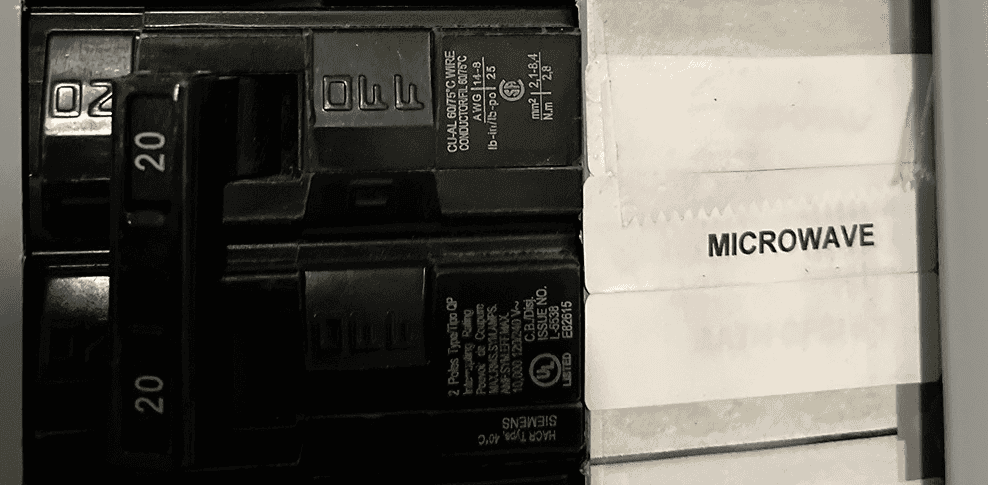

Just purchased a 2023 Lariat ER two weeks ago. The Ford Station pro was shipped out and received Friday. Install was today by the same electrician who wired my house and installed my tesla 60amp charger. Rate was $750 here in Texas and FCSP arrived exactly two weeks after purchase in mail for free.
I have a 100A breaker and an 80A circuit.
Ford F-150 Lightning Ford Charge Station Pro (2024 Review) 1712200894542-n4
I want to hear about this 240V microwave. I'm guessing you can pop popcorn in 30 seconds :)
