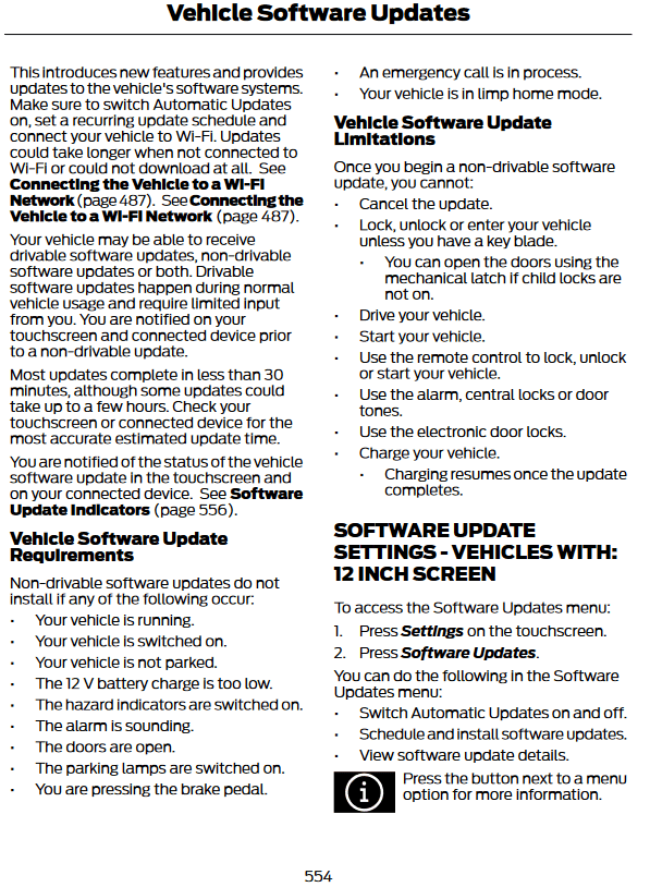

Your 12V battery SOC can drop down to 45% overnight. Unless some recent update to the logic has changed things, (it's possible) most updates require a 12V battery SOC of 80% before they'll process. Again, this may have changed recently so that number might be off a bit.

Well dealer techs do have "update packages" since the same module updates that are sent as OTAs are also (99% of the time) an available module update that can be applied in FDRS.
And there is a "master list" of module updates specific to every VIN that can be viewed in FDRS or PTS.
