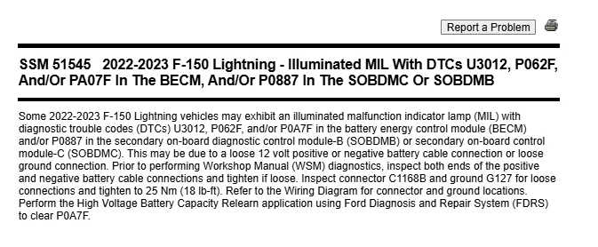

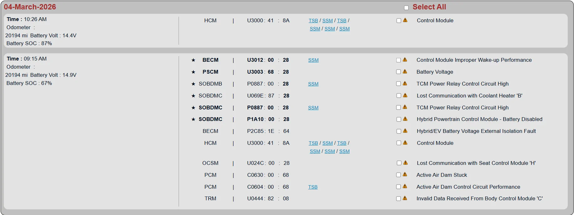

Fu$% Y%$ Ford. I can't believe for a second that there is not trouble codes somewhere they can see from the three hours of me dead at WallyMart! This is total horse shit. They simply threw up their hands and didn't even TRY to diagnose this thing.
I have your VIN. These are the codes that caused the errors. They are reported as stored codes today, but for sure they are in your DTC history.
Ford F-150 Lightning Ford LIES! 1772644092001-rf
Unrelated to what happened yesterday, you have a misconfiguration in your HCM. Not sure if you made some FORScan change that is causing this, but again, this is not related to what occurred yesterday.

To add to this, this is the SSM referenced by the P0887 code:
Ford F-150 Lightning Ford LIES! 1772664957372-pm
Below are all the stored codes your truck reported today. Notice that some of the codes referenced by the SSM are in your code history. Could this just be a loose 12v battery connection? Easy enough to check.
Ford F-150 Lightning Ford LIES! 1772665013402-t

In this case, I don't think so. He made some FORScan changes that are most likely the reason that code is there.
