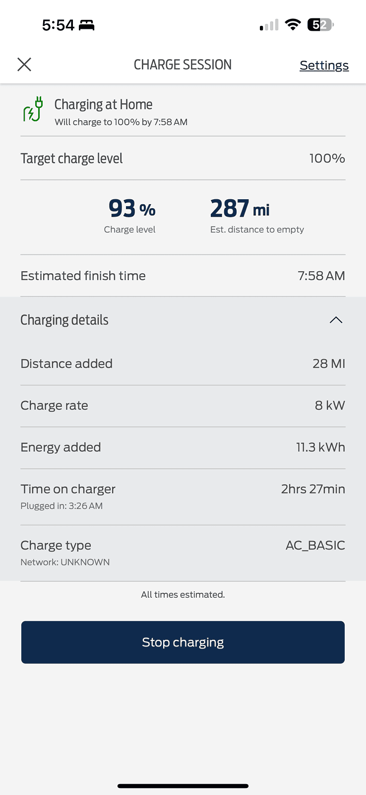

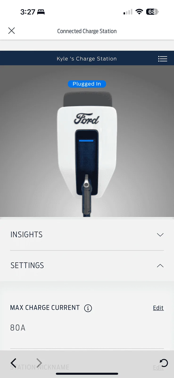

So finally, I can get my FCSP to connect to the Ford app after it had been disconnected for so long, great job, Ford. So I start getting insights again which is great but I am starting a solar project so I am curious on how easy it is to adjust my charge rate through the app versus doing it manually.
So I initially tried to change my setting, which is set at 80 A on the charger to 40 A through the app and it does not work for a few days. I get one of these updates on the car and trying again, and it works! But now I have adjusted it back to 80 A within the app and still haven’t adjusted anything manually which the charger is still set at 80 A. But now my charge rate is stuck at the 40 amp level lmao. It’s always something…

Treat it as a dumb charger and life will be simpler. If you want to change the charge rate, remove 9 bolts (T20 bit on battery powered drill) and turn the dial. Reattach cover w bolts. Keep expectations low.

I've noted the unreliable virtual controls of the FCSP via Fordpass in several other threads.
Until the FP app is fixed, we're stuck with unreliable adjustability.
One member, has a FCSP in a dry location (garage), he drilled a hole in the cover to allow easy access to the potentiometer setting, keeping the hole covered with a rubber plug when not adjusting it.

Only issue now is that manually I am set at 80 amps… but it’s only out putting 40 amps still
Try force stopping the Fordpass app, clear the cache (not user data) restart the app and retry adjusting the FCSP to a higher rating ~70 amps, sometimes this works, sometimes it doesn't.
