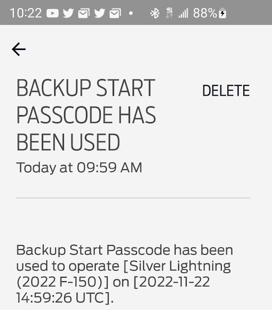

Yes, it works perfectly, I just tested it, with no key fob or smartphone/FP present:
  • Input my custom door code to unlock the truck
  • Pressed brake & ON button
  • Center screen advised no key detected.
  • Sync screen slowly woke up, displayed the password field.
  • Tap in the middle of the blank field
  • virtual keyboard appears, type in your password.
  • press the return key on the keyboard.
  • Startup completes and reminds you the key fob is not present
  • When you go into drive, it reminds you one more time, then no more once driving.
After returning home and viewing my phone FP app, I have an alert that the backup code as used to start the truck. Also got an email from Ford.

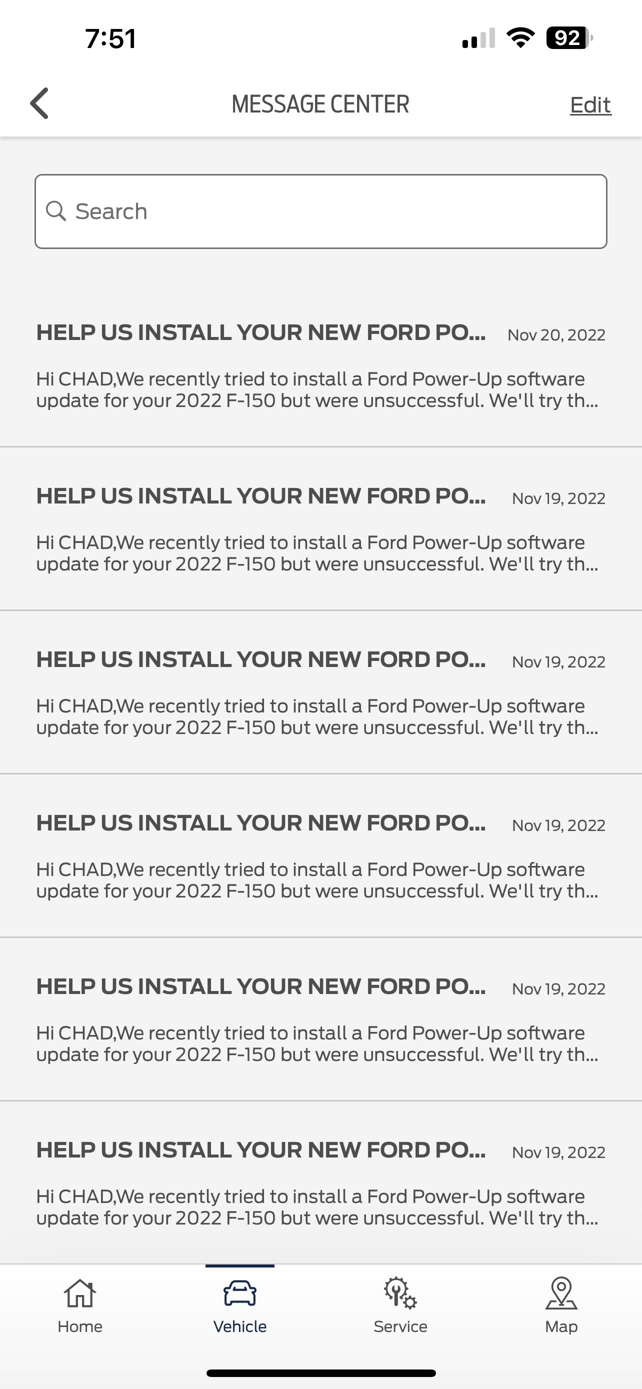

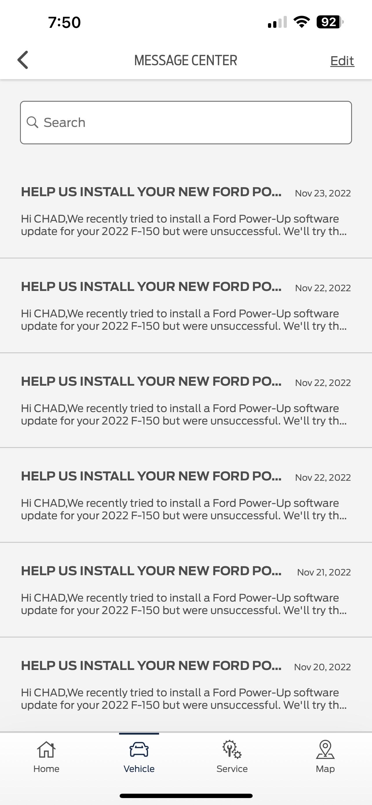

My 3.5.5 update won’t install for some reason. I get the same behavior as you. Displays the preparing update. I hear it power cycle a couple times then it just drops out of the update back to the previous sync menu.
I have tried updating after charging the HVB to 90%, updating while connected to my EVSE, charging the 12V battery, using the 12V charger in power supply mode while updating, driving for > 1hr then updating, letting it try to update on the nightly install schedule….still nothing. ?
If the reason for the failure is in Oasis and someone has access I can PM my VIN.

Well, after 20 failures in 12 days, I finally have the 3.5.5 update.

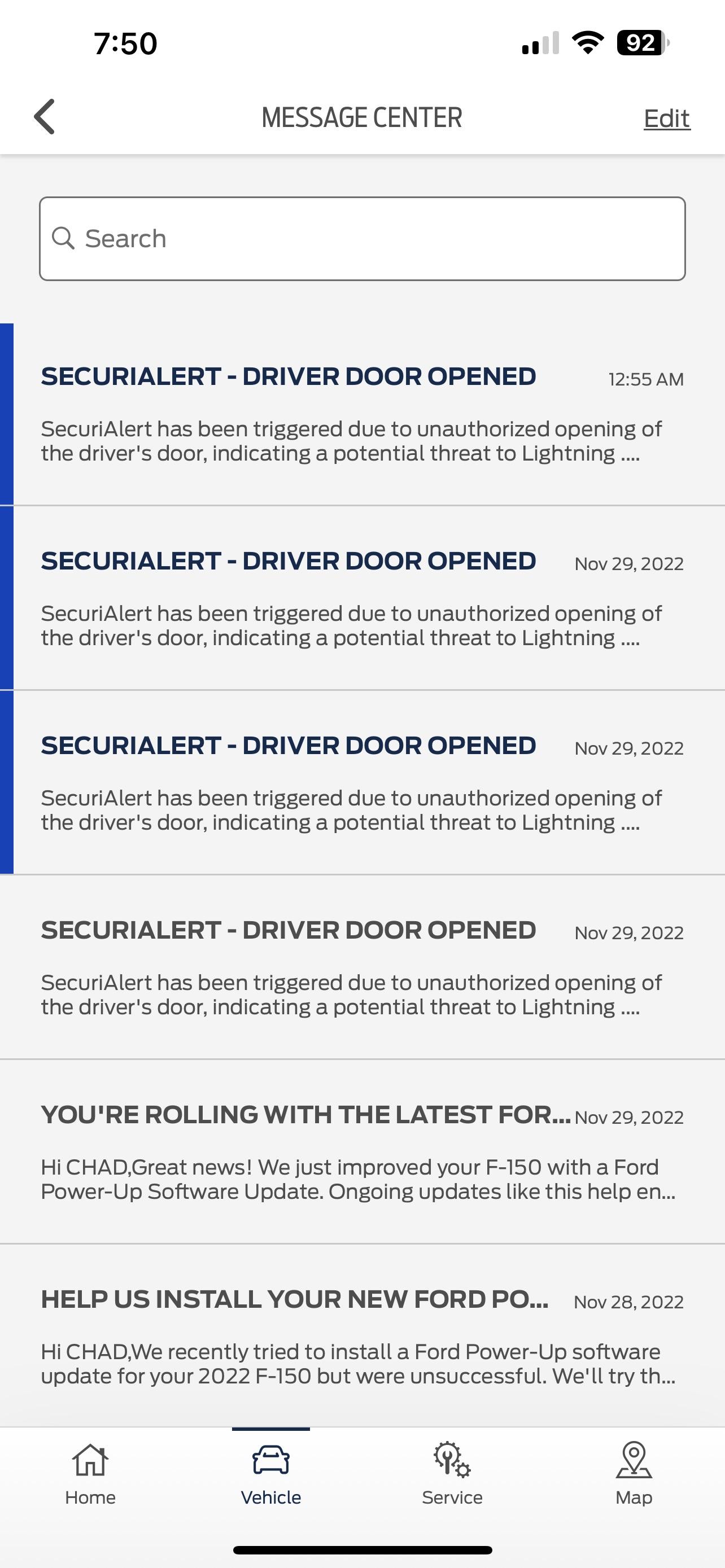

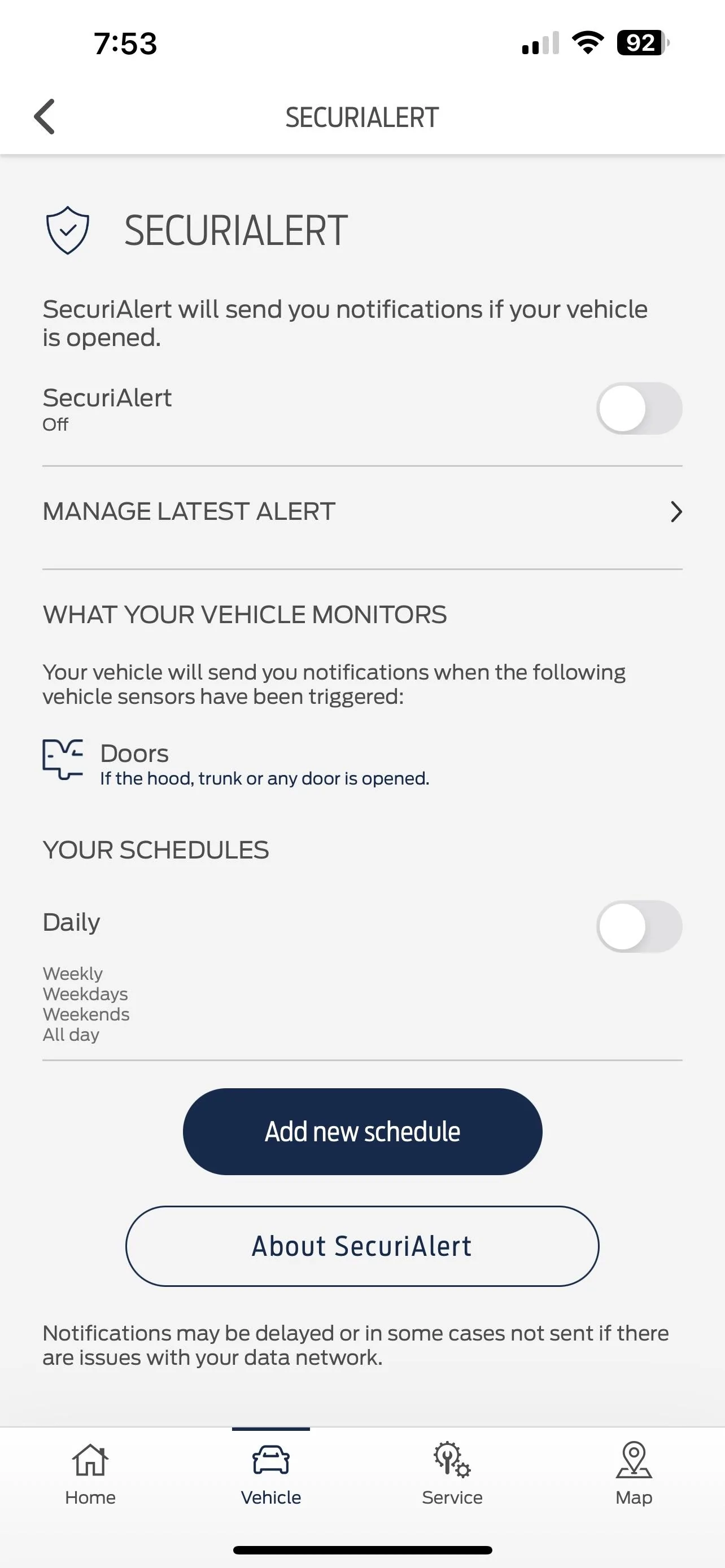

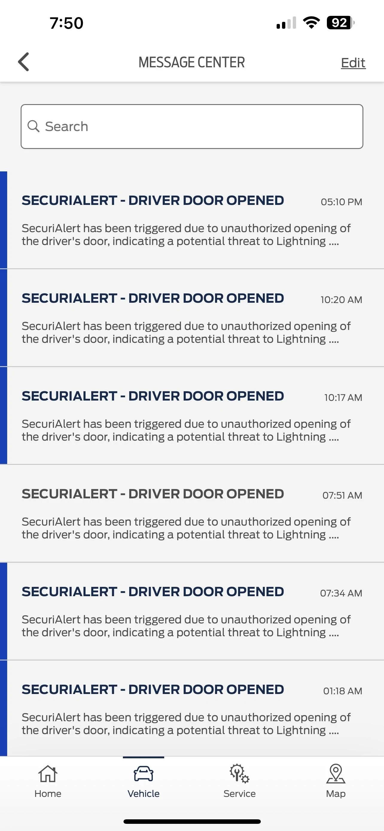

Since it updated, I'm getting SecuriAlert notifications on my iPhone whenver a door, trunk, or tailgate is opened. SecuriAlert is disabled on my phone. I've deleted/reinstalled the app but it did not fix the issue.
Has this
happened to anyone else, and how did you fix it?

Adjust the Secure Alert settings directly in the truck, see if that helps.

Any idea where those settings are in the menu? I couldn't find them on the screen, and no mention of SecuriAlert in the OM.
