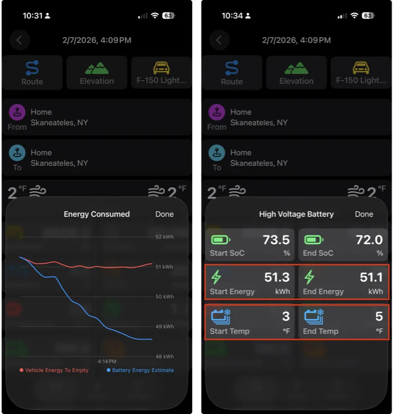

I'll guess your battery temperature is changing. I have found that the reported Energy to Empty value changes with the battery temperature and the Distance to Empty (aka the GOM) is tied to this value.
For example, I recently charged overnight and the reported Energy to Empty at the end of the charging session was 123kWh at 53℉. Left a few hours later and the battery was cooled to 28℉ and the reported Energy to Empty was ~110kWh.
Or on a test trip made today to compare the Mach-E and Lightning, in freezing conditions I used 0.2kWh according to the Energy to Empty but in reality it was closer to 2.8kWh:
Ford F-150 Lightning GOM Irregularities 1770521975367-q6
I had to give up using the Energy to Empty data point in the Lightning and calculate my own since it adjusts the reported energy content based on the battery temperature which it warmed by just a few degrees. I believe this is why you see jumps in the Distance to Empty/Energy to Empty after the battery haas been cooled or heated.

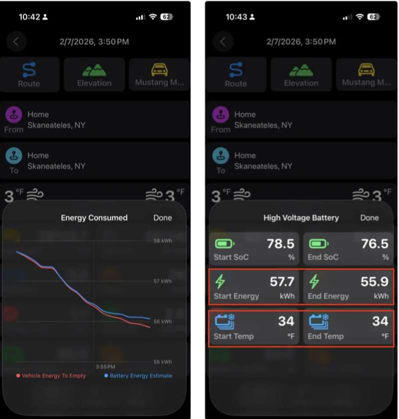

Compare to the Mach-E doing the same trip, battery temperature didn't measurably change (it was in an unheated garage) and Energy to Empty tracks closely with my calculated value:
Ford F-150 Lightning GOM Irregularities 1770522352045-sj

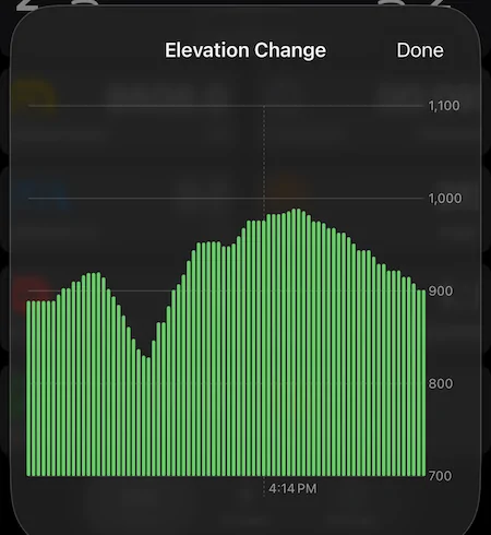

Fun fact, the slope of the energy line picks up the elevation change very nicely:
