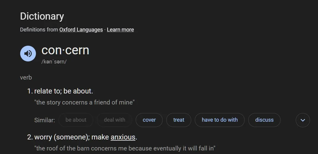

There have been some failures and if mine fails I might go with a rotary one but I'm not concerned about it.
Funny how the English language works when one doesn't fully understand it. #1)
