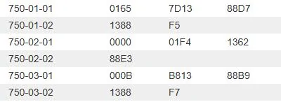

Interesting... There is AS-BUILT code for this module:
Ford F-150 Lightning Hacking the Pedistrian Warning System Sounds 1744319692516-3
(Code for my VIN) but I would guess they are all the same.
Yep, those are the lines from the <BCE MODULE> section. They are the parameters that you normally would look at changing with FORScan. Unfortunately the PACM module is not available for configuring in FORScan and it is not in @Livnitup's awesome spreadsheets. Too bad, might be some good stuff there.
If you look further in the As-Built file (have to download it, not view from the Motorcraft site), you will see a <NODE ID> section for each module with the F124, F188, etc. codes. The PACM is <NODE ID>750.

So I have a database I've been building of over 80 Lightnings from 22-25 plus a handful of ICE PowerBoosts. Interestingly the 22-23's (both ICE and Lightning) do not have any PACM info in the As-Built like you show. There is nothing there in the BCE section. My own 22 has nothing. I can only see module software numbers.
All the '24 and '25 Lightnings look to have what you have except for 750-01-01. All the 25's have 0065 instead of your 0165. For '24, some Pros (maybe fleet) also have the 0065. The ICE trucks for 24 and 25 only have useful info for 750-02-01.
