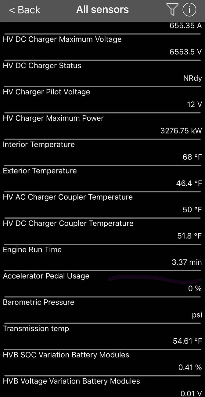

Car Scanner user here and was just monitoring this actually.
I'm using Interior Temp however don't expect it to read the "interior" temp, it seems more like raw sensor data.

When you say raw data, what do you mean? Thx.
There is a sensor to measure the interior temp, but where is it? It's not near the driver, so how does it know what the driver is feeling?
Generally there tends to be a sensor, or sensors, in the cabin. And from those sensors they determine what the driver is feeling.
When I say "raw" sensor values, it's what the sensor is reading but before any calculation to determine what the driver is feeling. Those calculations could be from the truck sitting in the sun for a few hours and the sensor is heat soaked. Or it could be in the cold, and the truck knows it's slow to update so it considers the BTUs it has been dumping into the cabin. Etc.
It could be a sensor on top of the dash. Or one in the air duct. Or in the center console.
Long story short, most every manufacture uses one or more sensors, but also applies various calculations or estimates on top of the sensor data.

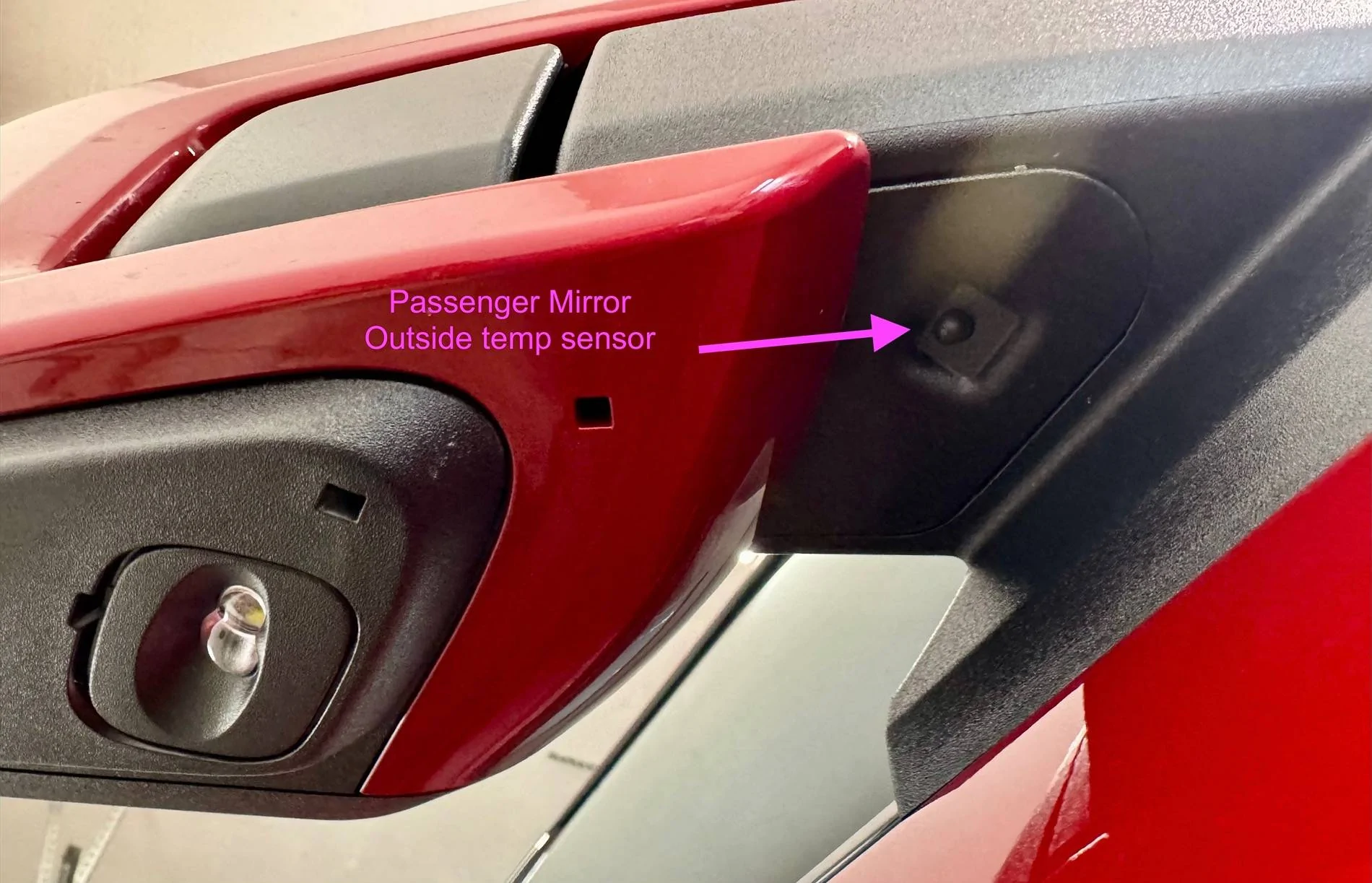

FYI, the outside temp sensor is under the passenger side mirror. Not sure where cabin sensor is, but may look similar.
Ford F-150 Lightning Does OBD or Forscan show Cabin temp? IMG_3114

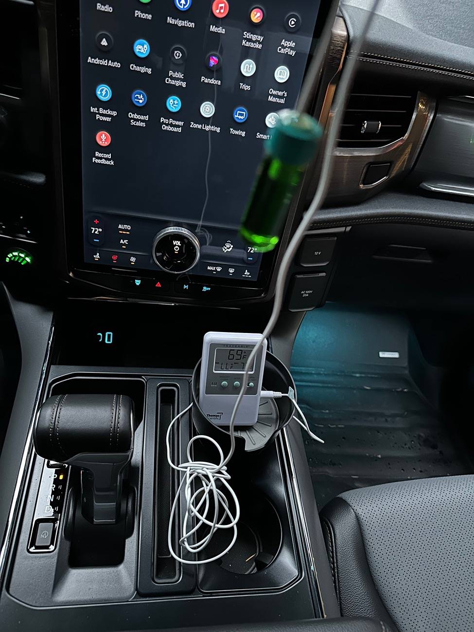

Ok, with access to Car Scanner and a decent scientific thermometer, and testing with an outdoor temp of 48 degrees, my test shows that the car’s interior temp deviates from the actual temp by being between 2 degrees and 4. 5 degrees higher (let’s call it an average of of 3-3.5 degrees).
That explains why I generally need to set the temp to 75 degrees.
To be fair, I think the scientific thermometer reacts slowly and so I want to rerun the test with a fast acting thermometer.
The goal is really just to recalibrate my thinking since it is taking a little more work to maintain temp. For example, when the car temp is 73, but inside the car is really 69, you feel the cold, yet the car is saying warm enough and stops heating.
when it heats it’s fine. The issue is getting it to heat consistently.
Ford F-150 Lightning Does OBD or Forscan show Cabin temp? IMG_5359

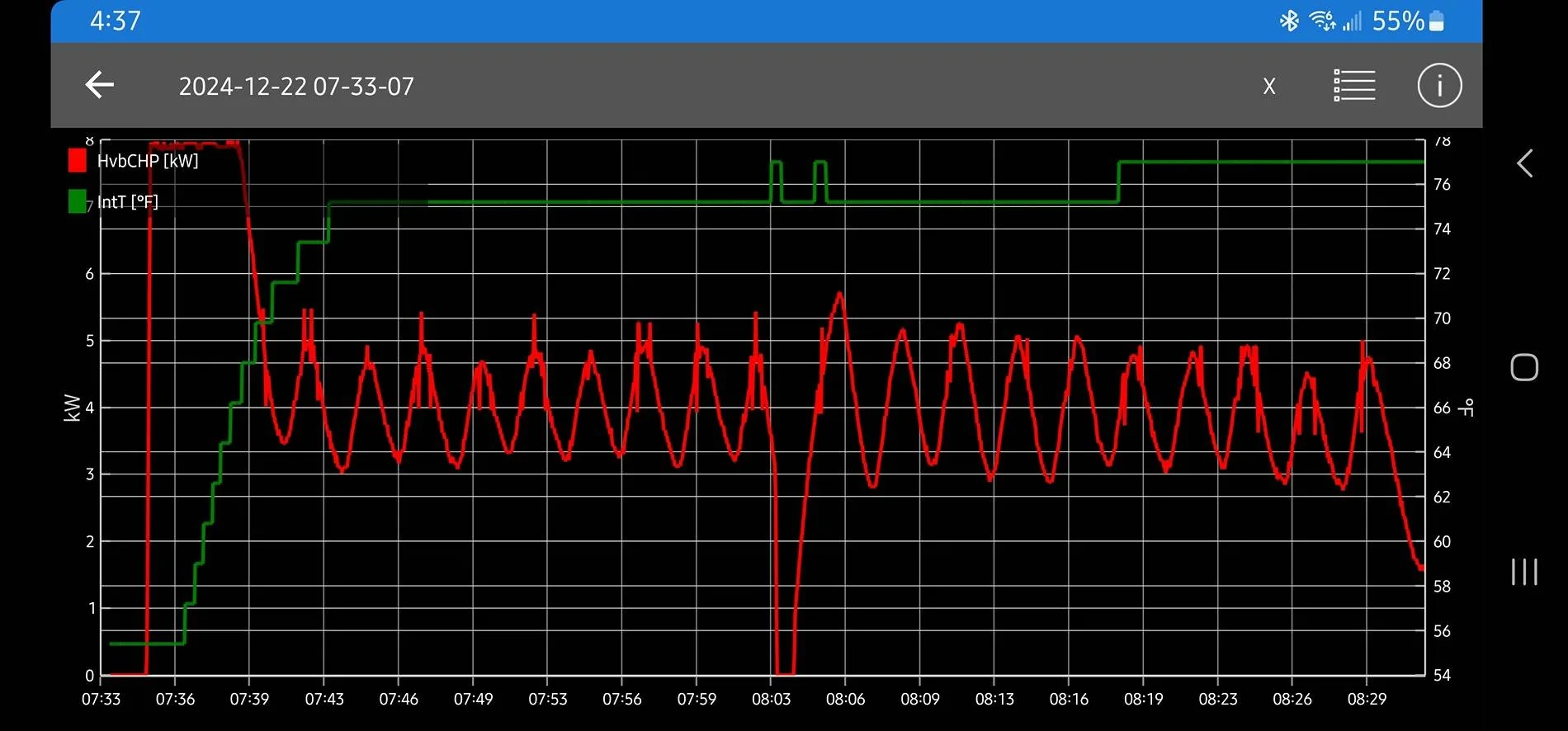

Here is a log of the heater power on a recent 1hr drive. This was for other purposes but it was at a controlled 70mph. Outside temp was ~20F and interior was set to 70.
Truck started from cold, leaving my 60 degree garage. The change in the middle was my halfway point and where I turned around. My guess is the truck automatically tries to account for thermal loss from traveling at highway speed, when I slowed down it didn't need to run the heater as hard.
You will notice that the interior temp was not changing, or at least the sensor value was not.
I watched the battery heater mode and it was off during the drive, the battery coolant inlet temp was also always cold. I do not believe that the heater was being used to heat the battery as it was warm enough.
Ford F-150 Lightning Does OBD or Forscan show Cabin temp? Screenshot_20241223_163706

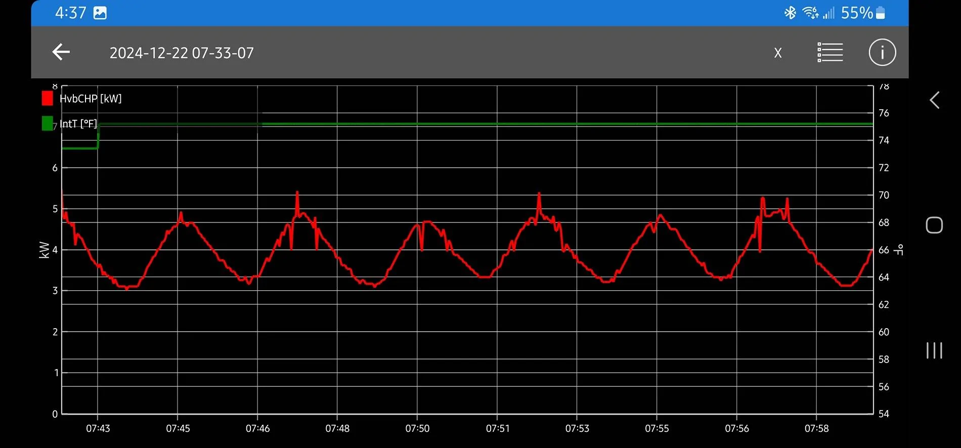

Looks like the periodicity for the heater was about two minutes thirty seconds.
Ford F-150 Lightning Does OBD or Forscan show Cabin temp? Screenshot_20241223_163743
