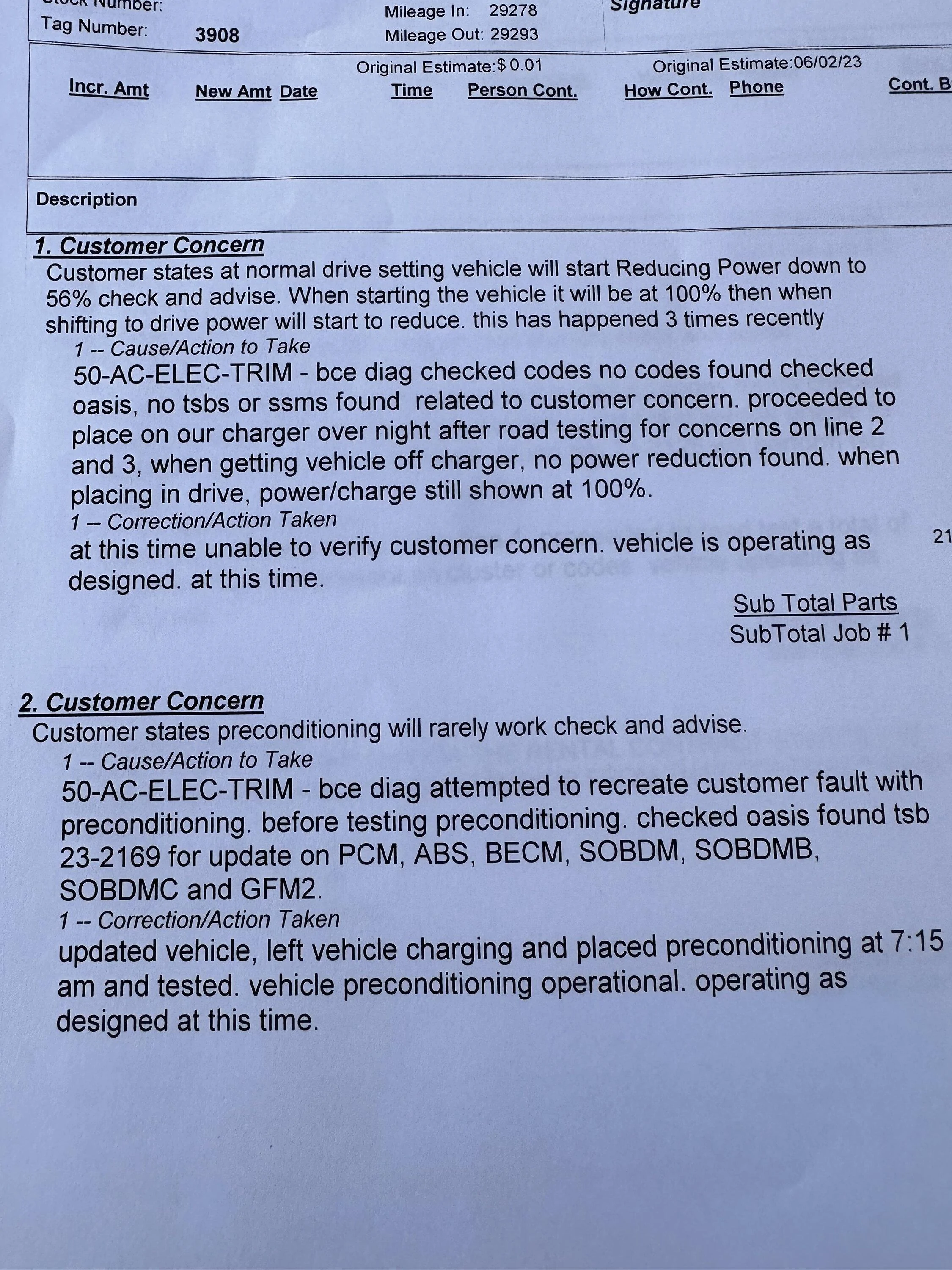

Mine does this from time to time. No codes, no errors, no messages in the app, no calls from Ford. Dealer "couldn't find anything". My power reduces at start up to 56% and the front motor doesn't receive any power or regain in the dash display. Truck feels fine driving although I don't push it. It resets in a couple start cycles, usually the same day. Happened to me maybe 4-5 times over the last 6 months.

This is about the third time this has happened to me. The first time it reset back to normal after shutting it off and then back on. This second and third time shutting it off and starting back up immediately did not work.
A couple of hours later though it went back to normal.
I don’t want to but will be taking it to the dealer, I figure this is something Ford needs to investigate, not only on my Truck but others that have had the same issue.

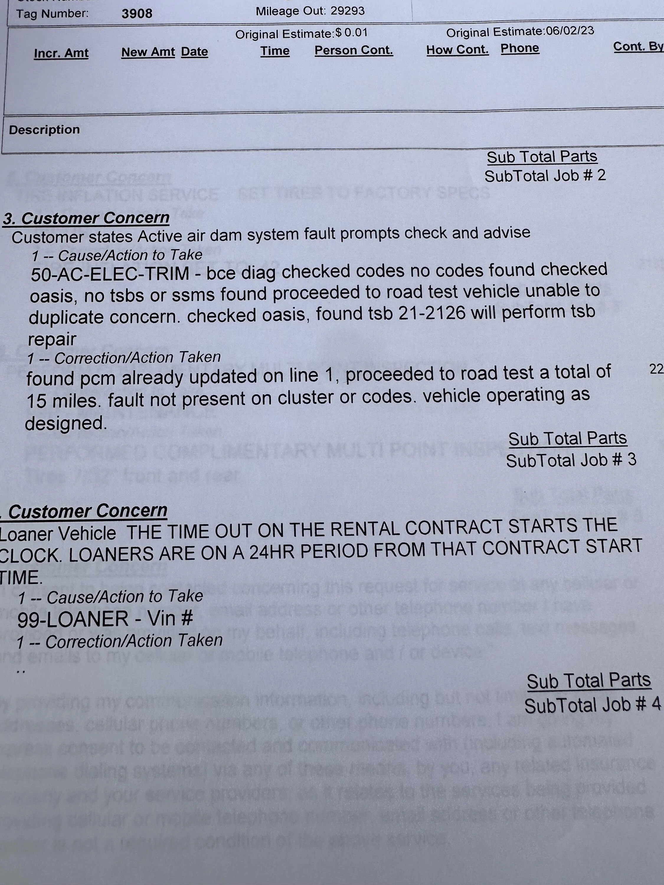

Update: Just picked up, they couldn’t replicate, as expected but I did have the two TSB’s for preconditioning and Air dam performed….

Wow, I’ll have to look at the air dam tsb. Tried the wd40, but still getting that error. Still shocked with the similarities of the battery issues there’s not a way to test the modules and make sure one isn’t throwing the error.

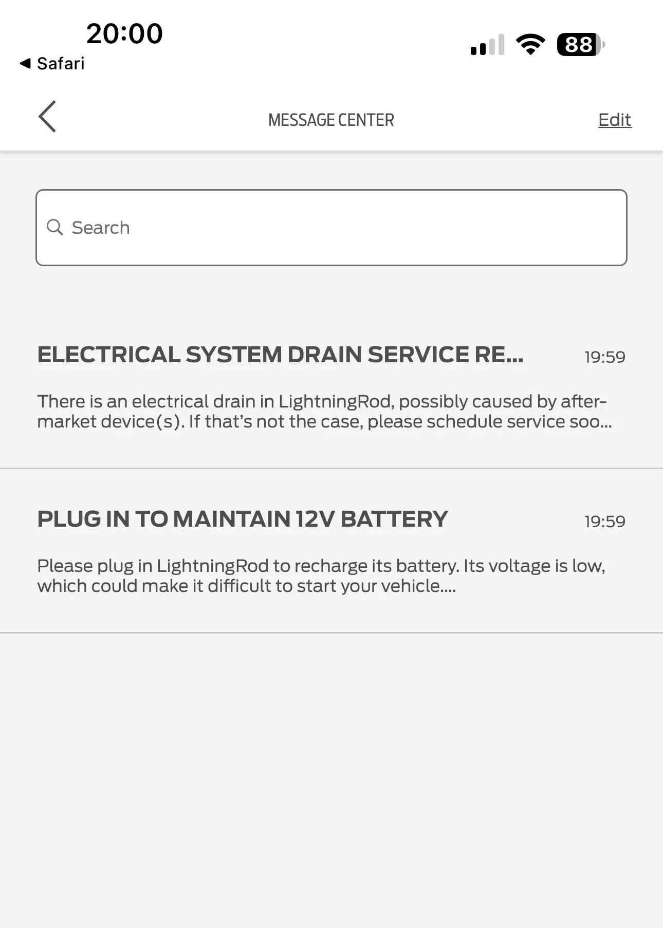

Smh…. I’ve never had this message before. But the electrical drain has always occurred when the % was below 40 and plugged in waiting to charge. Let’s see what I find in the AM.

Hmmmm, I just started getting the electrical system drain error. I have nothing plugged in.
