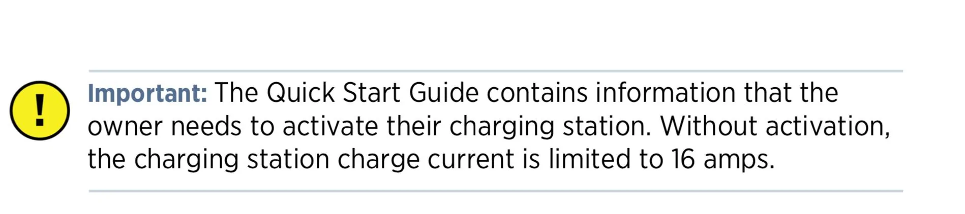

I don't know that you have to call Chargepoint, but I think you need to start the configuration over from the beginning to select a different amperage - if Chargepoint can do that remotely, that might be easier (although the setup was pretty fast and simple, if I recall correctly).
Hard wiring might require new (larger) wire, and a disconnect depending on the jurisdiction.
Even during initial configuration, you have to call ChargePoint. If you don’t, it defaults to the minimum of 16A.
Ford F-150 Lightning Home Charging Speeds 9482F5CC-3355-406A-8DC1-2F8E5F36ACEF
That was not my experience - the Quick Start Guide has instructions to connect to the unit via wifi and you get one shot at setting amperage. If you don't configure it, it stays at 16 amps. After configuration, there is no way to go back and change amperage.
