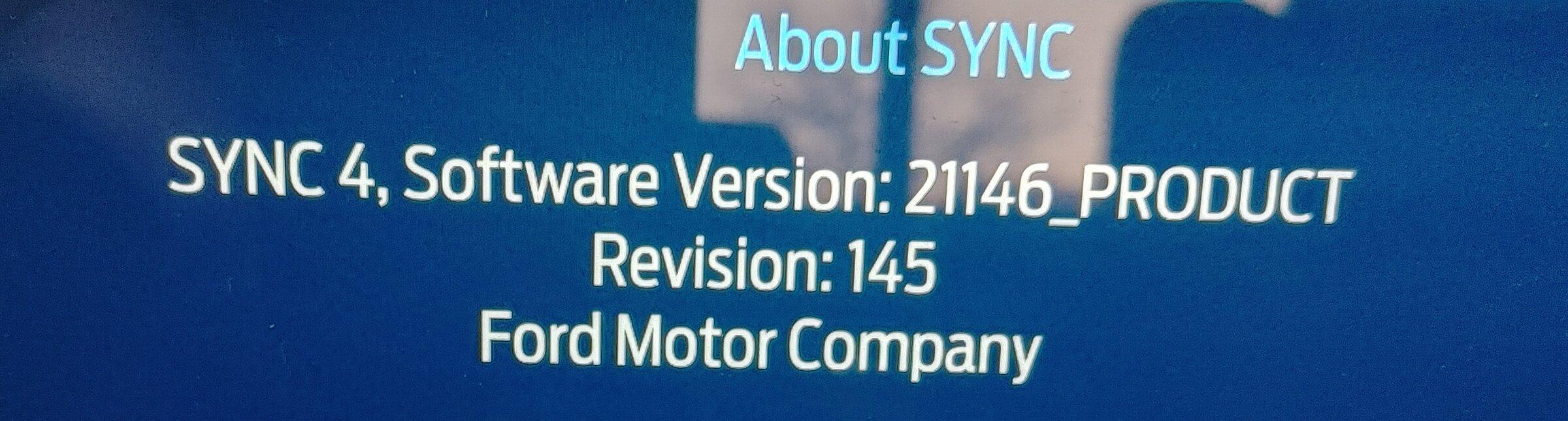

I just took this picture today of my 21 XLT 302A . March build, del May.
Ford F-150 Lightning How to find latest version of OTA SYNC4 Updates? Ver Number

21146 was the latest build for 21(job 1)
21223 was the latest for 21.5(job 2)
21136 was a job 2 build.

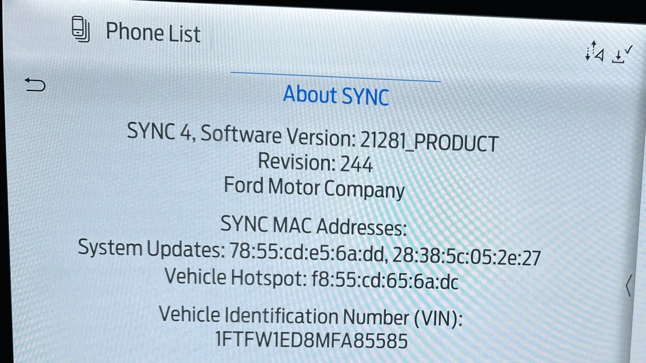

21281 was the apim update from the power up update 2.3.0 released for job one trucks as of now to bring them up to date. This is the version 22 is shipping with.
I bet they will send this out to job 2 trucks also.
