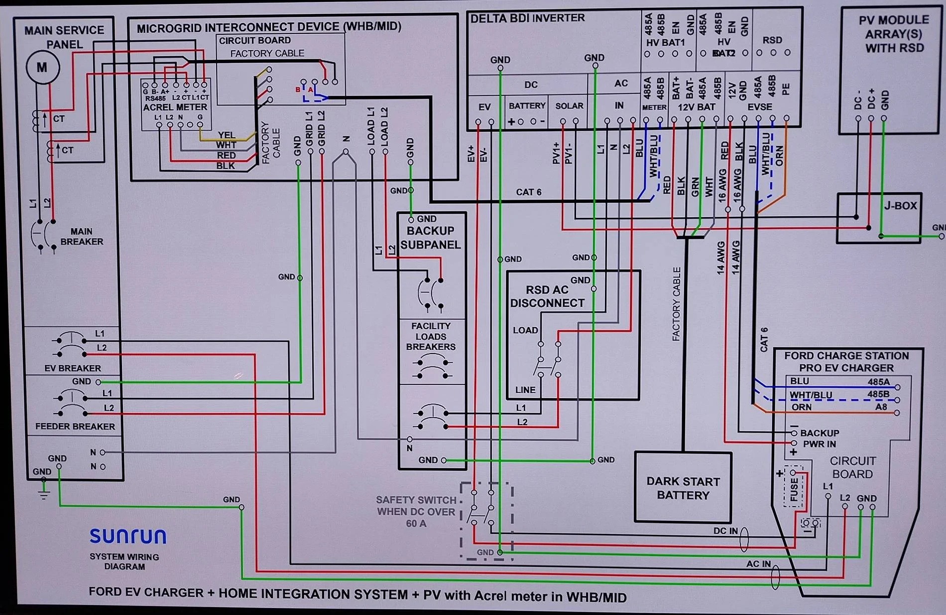

Random find, but this is the SunRun schematic for the Ford Home Integration, V2H. (I've never heard a single good thing about it) It's interesting to see where the grounds follow, though.
Like I said, I'm learnin' a lot! You electric gurus may find it informative as well.

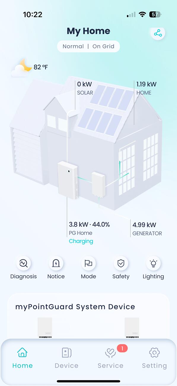

Here is a screenshot of my truck being used as the generator source, in conjunction with my whole home battery system. In this case the truck is powering the loads of the home, and charging the home battery with the rest. I set the rating in my app to request 5kW from the truck, and I can change this setting as I please. The screenshot says it is on-grid but it is not. The generator function is on a system relay that only closes when the transfer switch has already disconnected from the grid.

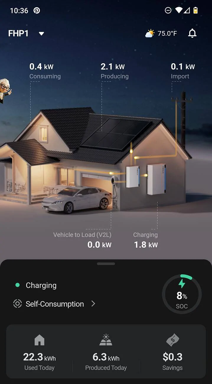

Also, here's a shot of my Franklinwh app, with the EV doin nuthin. LOL!

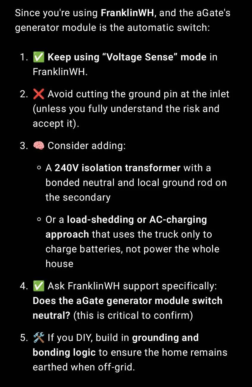

Here's what the sky brain said:
Ford F-150 Lightning I need someone to help me respond to this if possible. 1000012793
Do these seem to be the only feasible fully code-worthy solutions?

The last word from ChatGPT...
"There’s a reason you’re seeing a lot of semi-hacks out there. The Ford Lightning's 240V Pro Power was never designed to interface with whole-home battery inverter systems as a traditional generator. But with care, Voltage Sense + isolation transformer or manual AC coupling can make this work safely and effectively.
Would you like a sample wiring diagram for the transformer approach or AC coupling setup?"
