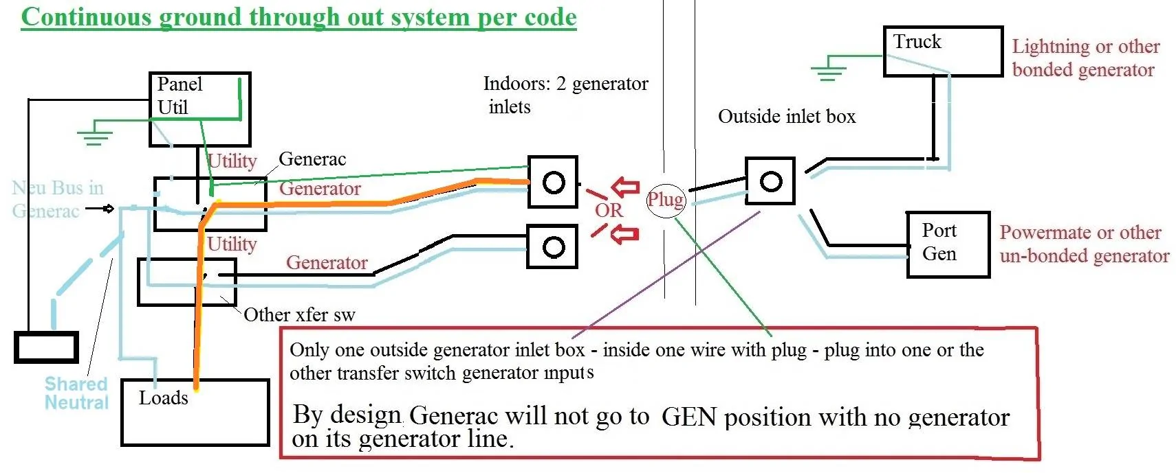

Ford F-150 Lightning I need someone to help me respond to this if possible. Block diag shared neutral problem
EDIT: the blue wires are neutrals - the black hots - the orange shows the path when using the Lightning.
So to use the Lghtning I plug the wire in my basement into the Gen inlet box for the GENERAC and then switch the GENERAC to STANDBY which connects the 10 emergency loads to the Lightning (have to reset the Lightning breaker due to the rocker switch tripping the Lightning breaker as described above).
If I am using a generator that is NOT bonded, I use the other inlet box in my basement that connects to the old transfer switch - that would be like your GEN input on your Franklin system.
Not shown in the diagram are the ground wires which are all connected together to provide a safe equipment ground per code.

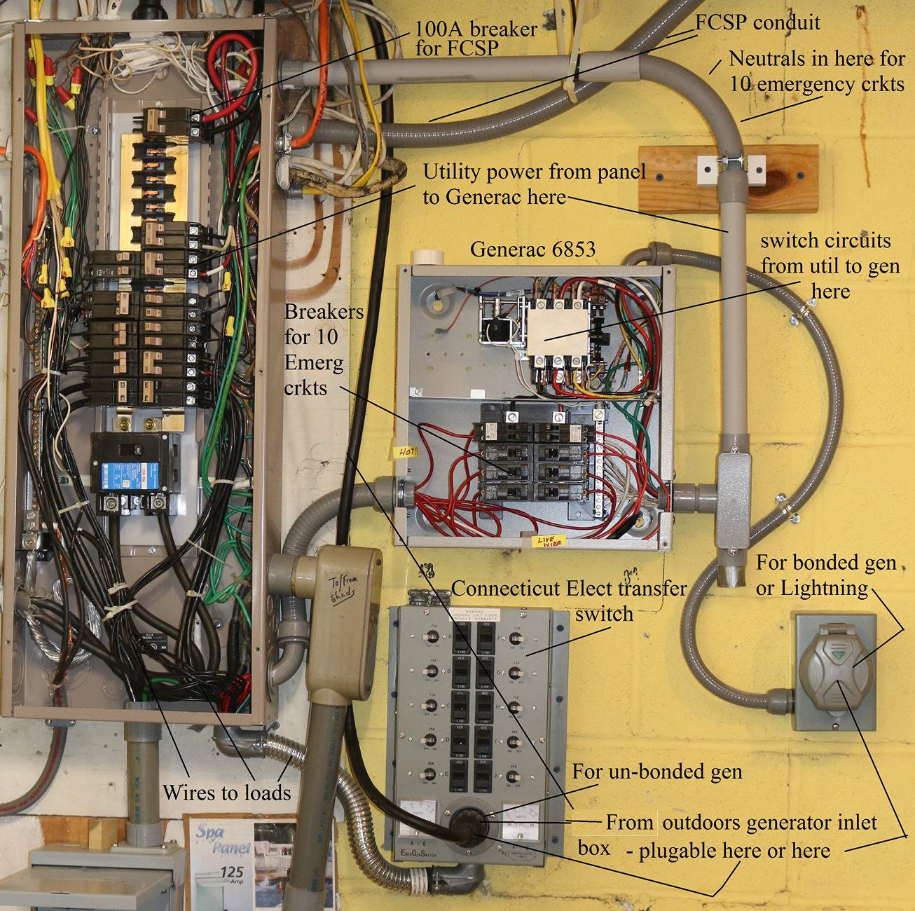

This is a pic of the finished set up with the service panel and the GENERAC open, labeled:
Ford F-150 Lightning I need someone to help me respond to this if possible. IMG_5926-final wiring before gen tests
Your system wiring may/will be a bit different, but your electrician should be able to figure it out from the block diagram.
I understand this may be a bit overwhelming in detail for a non-EE.
The bottom line is the above works, is safe, and complies with the NEC code.
When using the Lightning I bypass the GEN input on the other transfer switch, passing the current from the Lightning through the GENERAC and then through the old transfer switch on the HOT leads (red wires) to the loads (black wires in the service panel), while the neutrals of the loads returns to the Lightning through the GENERAC (white neutral wires are connected at the top of the service panel to the GENERAC white wires which connects to the neutral bar in the GENERAC).
When using utility power, the current goes from a breaker in the service panel, to the GENERAC, then to the old transfer switch (red wires again) to the load black wires, and returns on the neutrals to the GENERAC neutral bar which in utility mode is connected to the service panel neutral bar completing the circuits.
Good luck.
