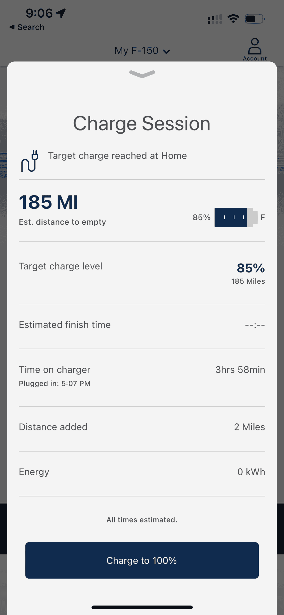

Thanks for your patience with my questions. Last one today; Can you keep the program and and override easily as needed? or you have to change/wipe it out every time you need to charge differently?
monsterlag
AJ
Jan 20, 2022
413
395
Albany
F150 Lightning, Tesla Model Y Performance
Well I don’t know about easy but on the FordPass app if you select “charge to 100%”, it will reset your limits to that. You would then have to go back to the FordPass app ->Vehicle -> Charging -> Charge settings -> Preferred charge times and then set it back to the percentage you want.
To deal with all this bullshit, I set reminders on my phone to change or set charge limits. It really is awful.
P.S - In the truck you will see an option saying “set one time charging limit”. This does nothing for home charging, it’s a limit for L3 DCFC charging.
