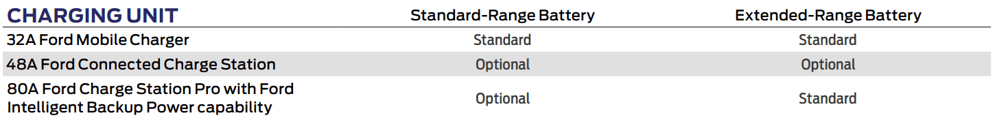

This shows in Ford's material that the charger was included, wonder who yo contact regarding that. Don't get me wrong...I'm extremely grateful for the price match for us extenders, but curious if the consider that part of this?
I decided to order it figuring there was a better chance that they would include it for free vs. give me a credit for something I didn't get. Its not worth the $500 but I won't feel too bad if I end paying for it.

I got it free with my Pro so it’s fine, but I wouldn’t pay $500 for it. Go on Amazon or eBay and order a mobile 40amp charger for a few hundred and enjoy faster charge times for less money.
