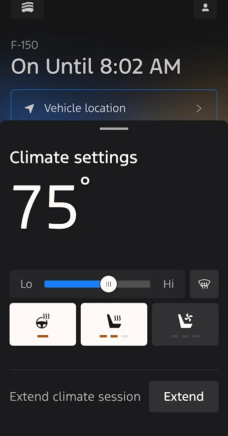

I have had a concern for the functionality of the heated seats adjustment button for current and many prior versions of Ford App / Pass, it's 50/50 chance that the settings will be the same after "Starting" the truck.
I've tried leaving the Sync settings as automatic or last used, doesn't matter with regard to that.
It's also as unpredictable using departure timer or remote-climate start button.
First world problems, but if you have a function, make it work as animated.
