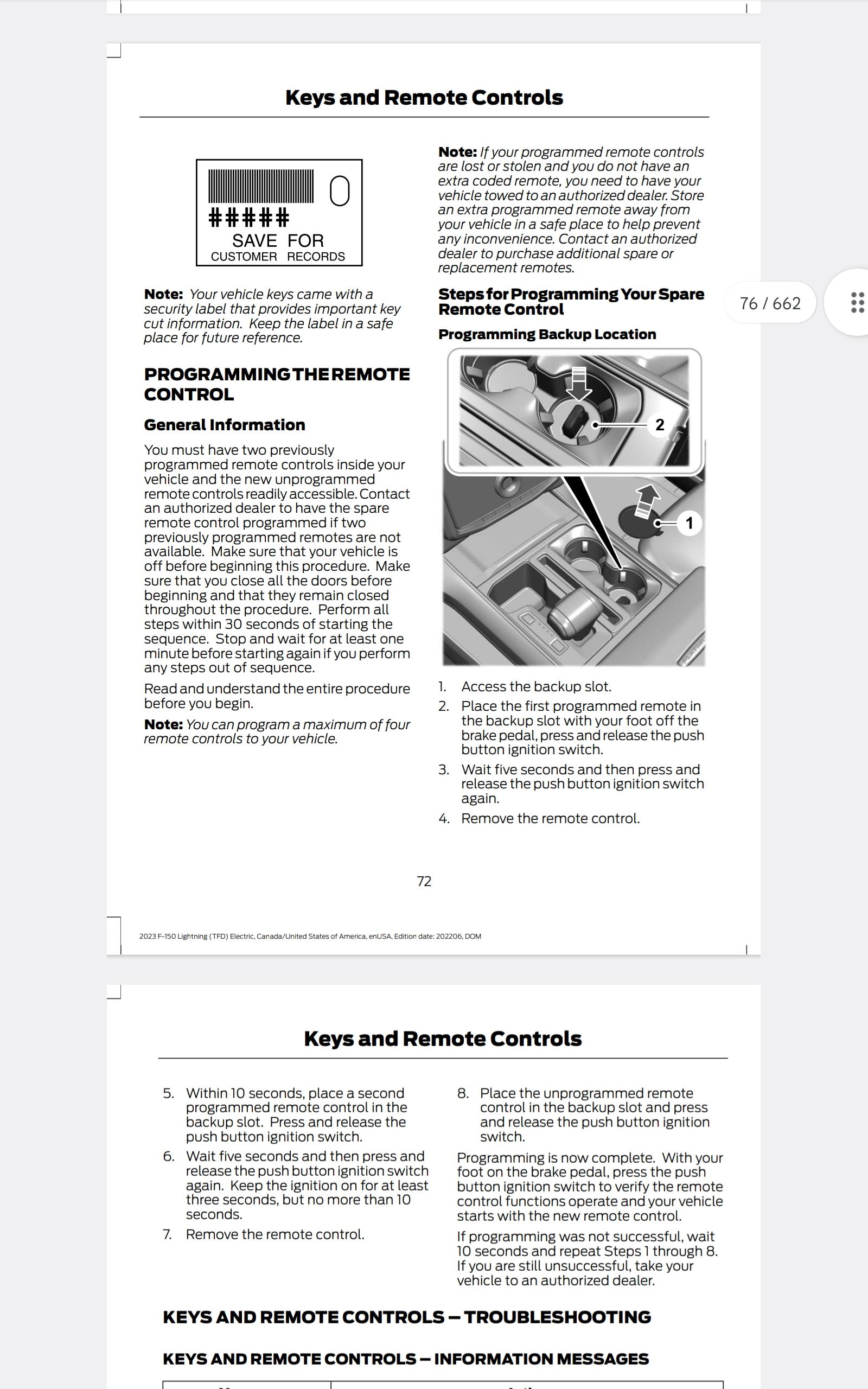

For those of you that say it’s easy to do if you have two fobs…. Can someone explain how?
Based on these prices, I might just buy an extra and program it just in case…
Page 72 of manual.
Owner.ford.com for a pdf copy.
Not a Lightning, but I programmed an extra FOB for my 2021 Lariat using this procedure. This should work.
