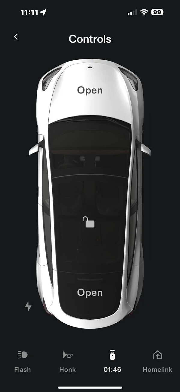

Yes, The procedure is
11- Unlock the car with the APP
2- Select Start on the App
3- It allows anyone to then get in the car and drive it as long as you get in and drive it within 2 minutes. If not it times out.
It will continue to keep the car alive and allow it to be driven until the driver exits the car, then it shuts down.
I have a elderly lady close friend who's phone failed to unlock her Tesla. I also am on her account. She called me panicked that she was locked out of the car after taking a walk at a City Park. I remotely unlocked her car from 300 miles away using my Tesla App. Then I "started" her car with my App. She got in and drove it home. She now carries her Credit Card Key with her. After she power cycled her Android phone the PaaK worked again.
In an Emergency Tesla Support can also do this remotely if you call them and you answer their security questions.
EDIT: You can see the time out at the bottom of my Tesla APP now. After I activated the Start is shows 1:46 left until it times out.
