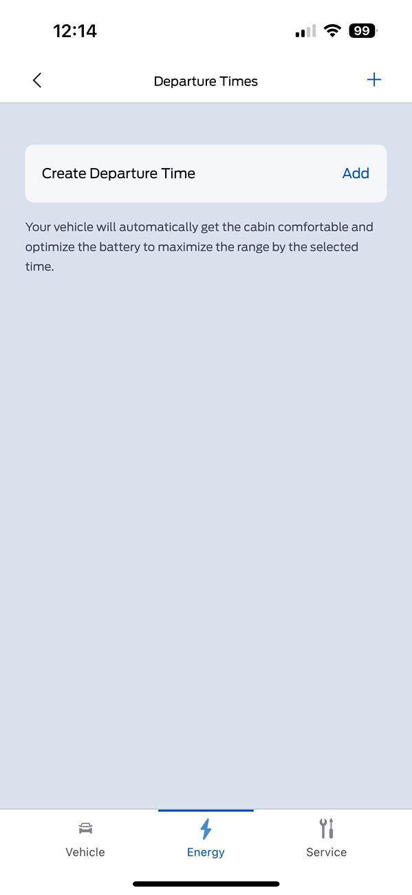

My truck is plugged in to the FCSP in an unheated garage and hasn’t been driven in two days. As with much of the country, NE Ohio has been very cold. I checked the app today and my truck was showing it was preconditioning for departure. There are no departure times set and have never been set for that time. Is it doing this to keep the battery at a certain temperature?
Ford F-150 Lightning Lightning preconditioning for departure by itself. IMG_6728
Ford F-150 Lightning Lightning preconditioning for departure by itself. IMG_6729

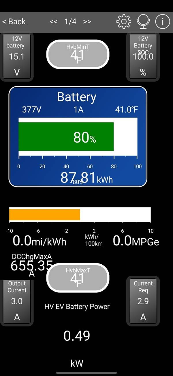

Yeah they try to avoid the battery getting too cold. I've noticed this twice today also with the temp in the 20's where it ran for about an hour and used 1kWh both times. When I checked the battery temp in CarScanner, it was showing the battery temp as 41F so a bit above freezing.
Ford F-150 Lightning Lightning preconditioning for departure by itself. 1000008444

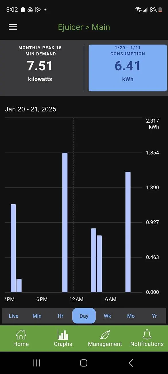

This is how much my truck used in past 24 hours to keep the battery warm in Maryland.
Ford F-150 Lightning Lightning preconditioning for departure by itself. Screenshot_20250121_150257_Emporia Energy
