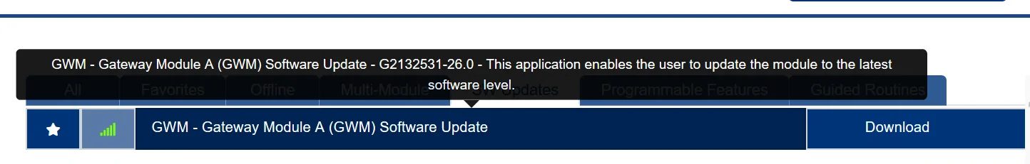

FWIW my previously up to date '22 Lariat ER now has a GWM update fresh today. Wonder what it is....

ICE trucks started getting a new GWM OTA about a week ago. The OTA version is 6.1.0 and 6.2.0.....there are two of them. It is believed to be precursors for BC 1.3 for our trucks.

Looks like this is 6.1.0 and downloading OTA. Nice to see it coming OTA so quickly after being posted on FDRS.
That's how it should be.
