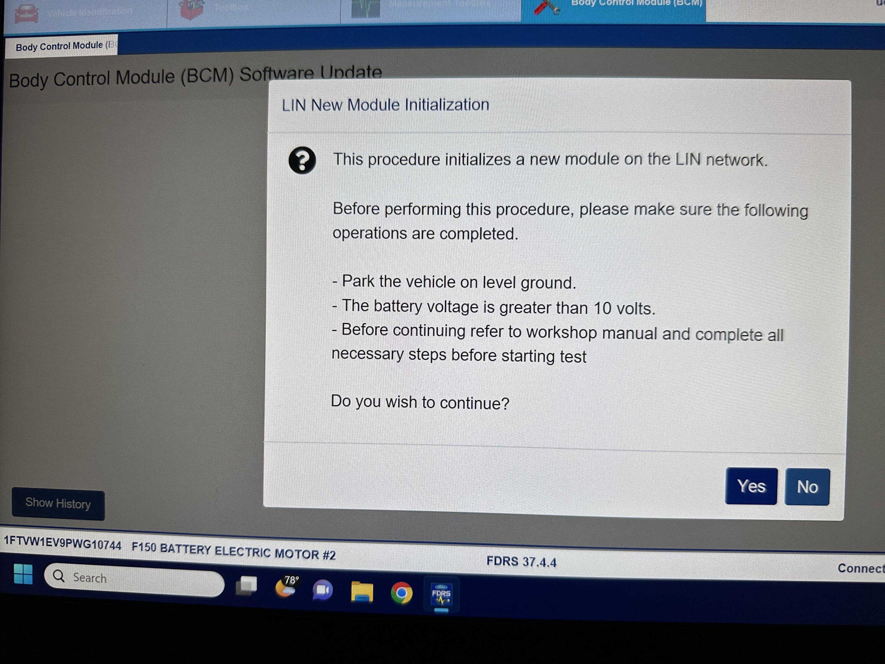

Doing the BCM last brings me to LIN new module initialization. I’m on level ground and the voltage is set… but not sure about any extra steps in the workshop manual. ?. Abort or go? Lol
Pretty sure that’s not part of the plan.
That didn’t happen when I did the BCM.
The verbiage was a bit different too - "Turn to position I" and "Turn to position II". That was the only funky thing that happened all the rest installed ok. The frunk would not close after being open for 4 hours but got that sorted. Used a Clore PL2320 and saw some dips down to 12v - ?. Gonna go ahead and get a better one. Thanks for the tutorage!
Frunk will always have to be closed manually one time after programming is done. It will open and close electrically after that, as normal.
I've seen it dip down to as low as 10.1V.
Once.
And then I pulled my Powerboost alongside and very quickly attached the jumper cables to the backside of the PL2320's clamps to get the voltage back up on the MME I was programming above the near-death experience. I then got on Ebay and bought a PL6100.
I later found out from another member who was thinking outside the box that it would have been cheaper to just buy another PL2320 and piggyback the clamps. Smart guy that one.... That's what @AmandaB does now and it works fine.

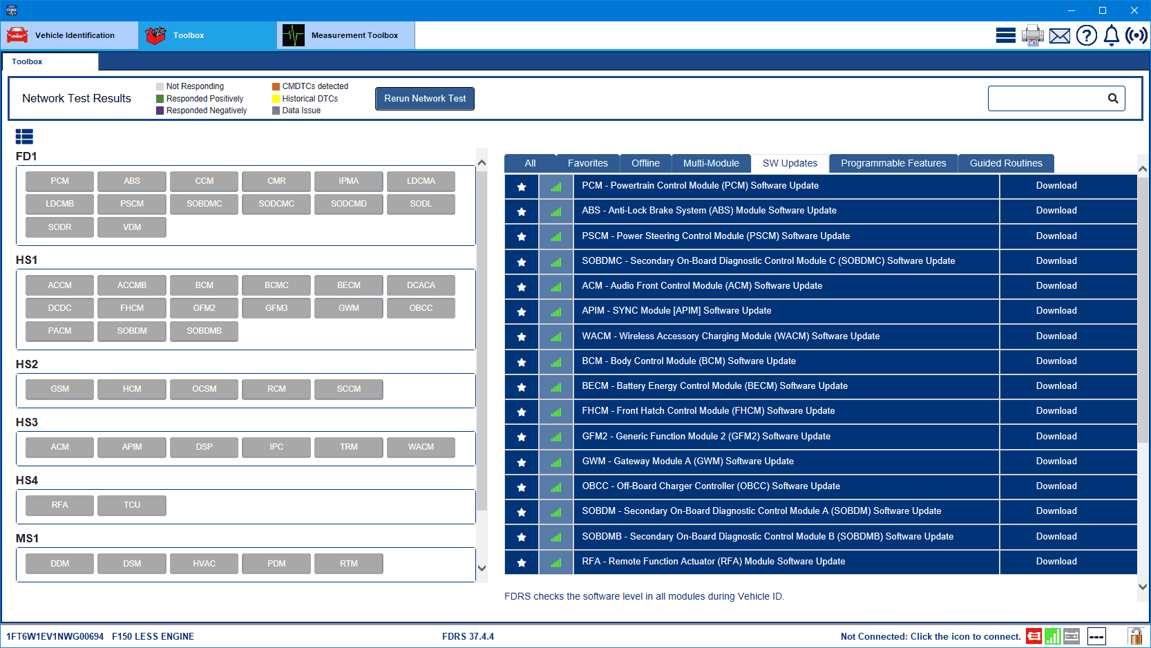

Thanks for all this useful info here. I just got my 22 Lariat ER last week and want to get all the updates. I just ordered the Mongoose and a 2nd Clore PL2320. Would someone mind taking a look at my VIN, so I can get a head start? Thanks
VIN: 1FT6W1EV1NWG00694
5 Apr '22 build date.
Here's the list of available updates:
Ford F-150 Lightning Lightning Software Updates using FDRS 1FT6W1EV1NWG00694-20-Sep-23
Is your PAAK working? I only ask because you have two of the updates that I thought were required for it to work.
Also, you have both a GWM and an APIM at the same time in your list which is an indication that your truck has not been getting routine updates for some time.
When your Mongoose gets in and you have a high speed USB 3.1 32GB thumb drive I recommend you start with the GWM first, the APIM next, any other GWM/APIM/ or TCU that pops up after that and once those are all done then start on the PCM which will do all of your powertrain updates in a scripted sequence, and then go for the BCM and RFA, and finally the ACM and OBCC.
That will keep you busy for about one morning. Remember Ford does server maintenance on Sunday mornings....
Thank you so much Mike for looking this up and the help on the order of updates. My PAAK does not work and is not even an option in the Ford Pass app. Ford Pass support told me my software was out of date and have the dealer update it. Dealer told me 2 weeks without a truck, which led me to this thread.
