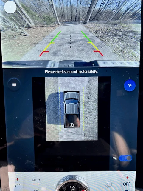

@Mike G Did you apply the new IPMA update to your truck yet? Did this happen to yours, too?
I did and I'm going to go out shortly and see if my 360 view is of a similar scale. I really can't remember from the last time I backed up what it looked like (4 days ago). I will post back. I was thinking that maybe a 360 camera alignment might adjust the scale of that image but...dunno yet.

So I just went out to check the 360 view during backup....I guess this is the new normal? You can certainly see a lot more around the truck but I would prefer to see obstacles that are nearer. It's kindof hard to judge just how far away you are from an obstacle unless you took the time to stop and zoom in to check.
I strongly suspect this is going to need an APIM update to scale the image correctly. The IPMA seems responsible for sending these feeds and must have changed the dimensions or aspect ratio.
I think you're right. And also, I don't think a 360 camera alignment would have any effect on the problem. It looks like my cameras are in perfect alignment so I don't think doing that procedure would affect the view that I see now.
I agree with you -- this seems like yet another one of those protocol incompatibilities similar to the TSB about the new SCCM and old IPMA being incompatible. And we expect BC 1.4 involves another APIM update to expose the settings at least.
I also find my view perfectly aligned (just the wrong size) and expected that if the update lost alignment/calibration it'd give a different error message or at least a DTC. Looking at the other F-150 forums it doesn't look like tiny 360 degree view is a symptom of misalignment.
