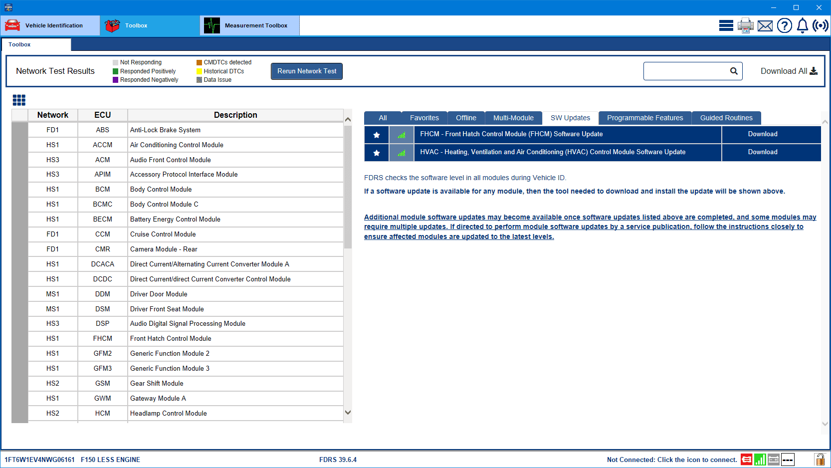

So no new exciting APIM update this morning, just another front hatch and HVAC update.
I can't see if I have any OTAs waiting but I have started the truck and will let it run for 30 mins to see if anything downloads.
Ford F-150 Lightning Lightning Software Updates using FDRS Lightning_FHCM_HVAC-15_Mar_24

6.14 has to be waiting. Maybe soon.
