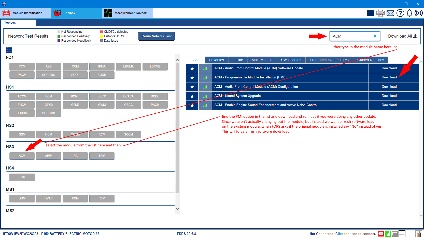

Setup your rig as normal to do an update.
Then after viewing and clearing any current CMDTCs, go to the toolbox tab, (see below).
Ford F-150 Lightning Lightning Software Updates using FDRS PMI_the_ACM_module
To find the module you want to work on you can do it the long way, which is scrolling through the list under the "All" tab...or you can type it in to the search box like I did to limit the view to just things you can do with the ACM...or you can just pick the ACM module from the panel on the left side, and it will restrict what you see on the right side to things that only apply to that module as well.
Select the PMI option to download and then "Run" and follow the instructions. That's pretty much it.

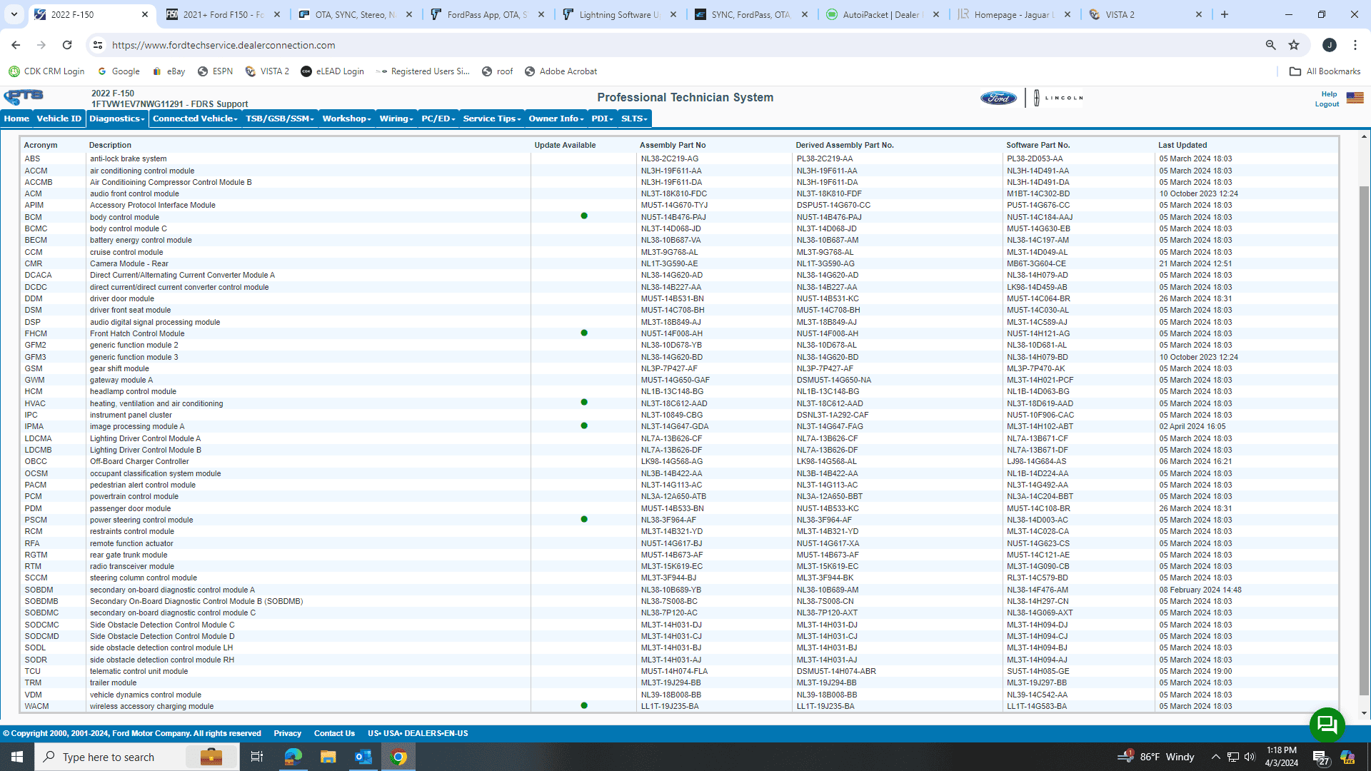

Vin# 1FTVW1EV7NWG11291. I would also like to receive the FDRS for my Vin. THANKS FOR THE INFO!
I don't have access to FDRS at the time, but this is what PTS is showing pending for you:
Ford F-150 Lightning Lightning Software Updates using FDRS 1712164703561-6o
