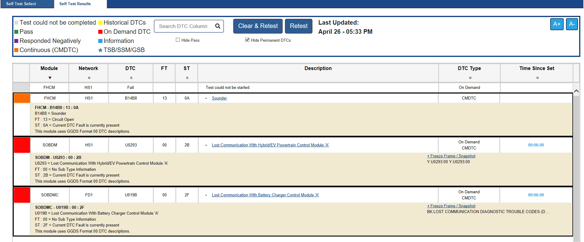

Here are the actual errors I received. I took it for a short drive and I didn't get any popup errors in the instruments cluster. Tried PMI on each of the failed modules and the PCM telling FDRS I didn't have the original module, so it would download the config from Ford. Errors still showed up even after clearing them. The one bit of good news is that installing the modified frunk beeper back in got rid of that FHCM error. I just removed the black/ground wire inside the frunk beeper and taped it off then put it back together. No beep and no FHCM error. Truck is charging now, so I am not sure if those errors will cause any observable issues or not.

Yes...I was advised that you could resume doing powertrain updates. But the DTCs will likely still be there until they provide a newer update to address it. It is a benign condition and I'm told it doesn't affect driveability (the SOBDM and SOBDMC DTCs) .

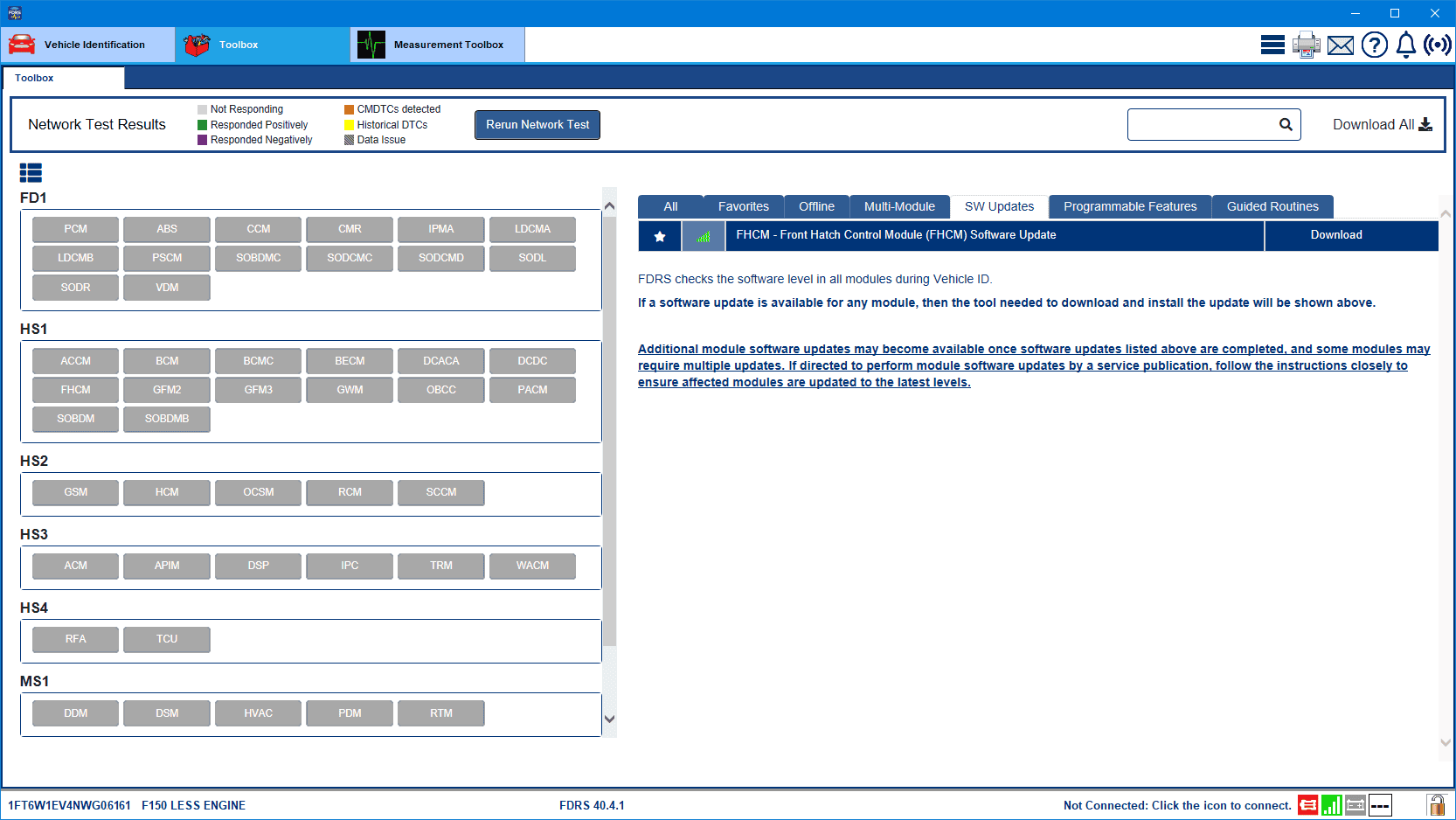

On a different topic, yet another front hatch update showed up this morning for my '22 model:
Ford F-150 Lightning Lightning Software Updates using FDRS Lightning_FHCM_27-Apr-24
I'll do that one the next time I'm connected...as I'm not really having any issues with the frunk right now...so I'll leave it alone.

Thank you Mike, I feel better about the DTCs. I just checked and I have another FHCM as well.
