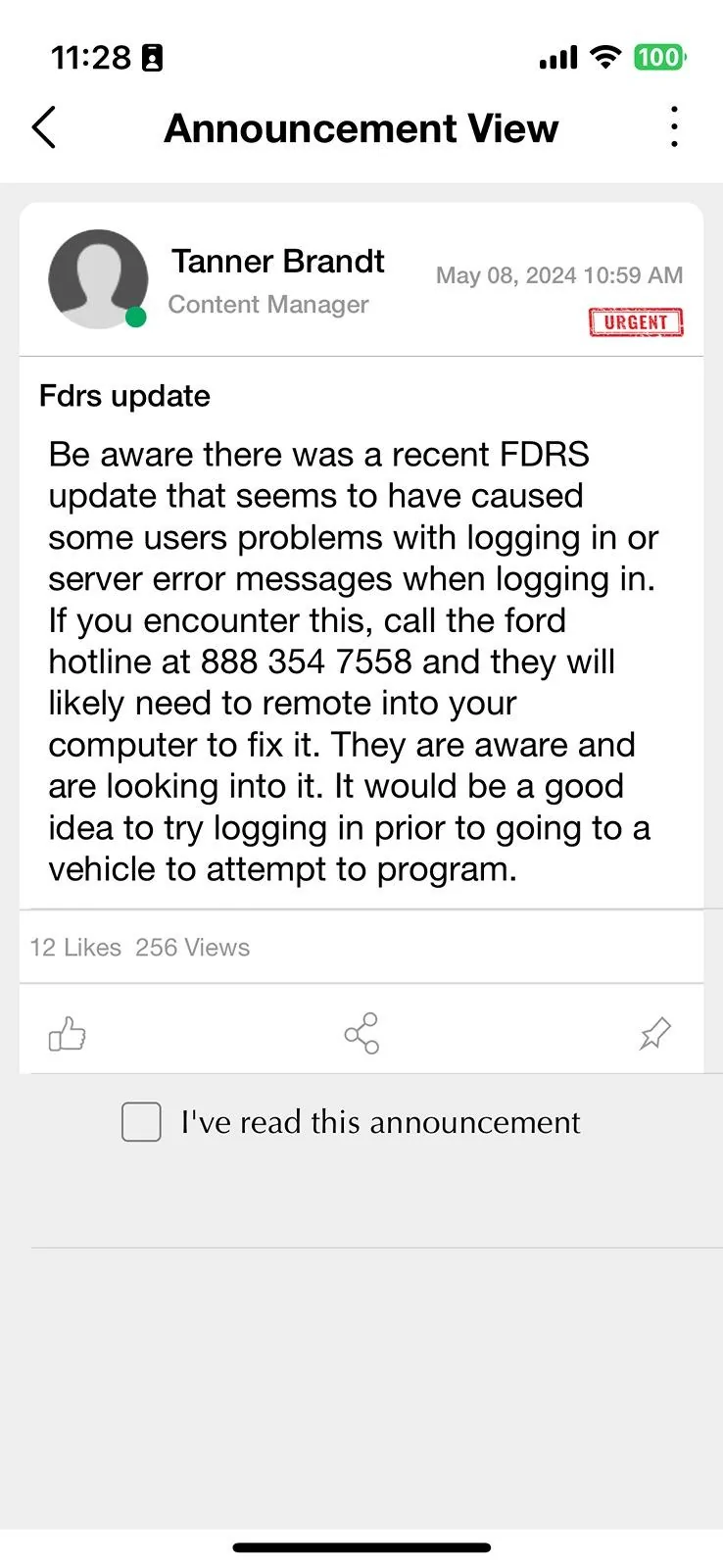

I found the following announcement in the NASTF forum itself which appears to describe the issue of FDRS failing to accept NASTF credentials. As rugedraw stated, given that those lurking here are just owners and not vehicle security professionals... nothing to do but wait for Ford to fix it.
Ford F-150 Lightning Lightning Software Updates using FDRS Screenshot 2024-05-14 at 11.28.07 AM
