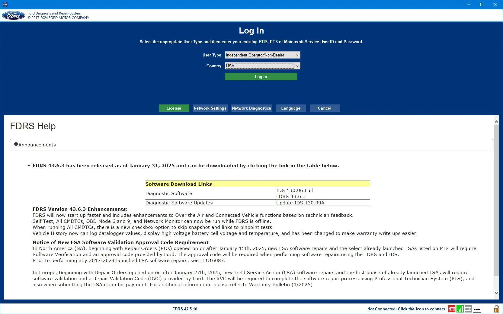

Download link to the new FDRS 43.6.3
Ford F-150 Lightning Lightning Software Updates using FDRS FDRS_43-6-3_Now_Availabl
On all major releases like this one, remember to tick the box to 'remove user data' during setup, or you might end up with some strange results the next time you try to use the program.

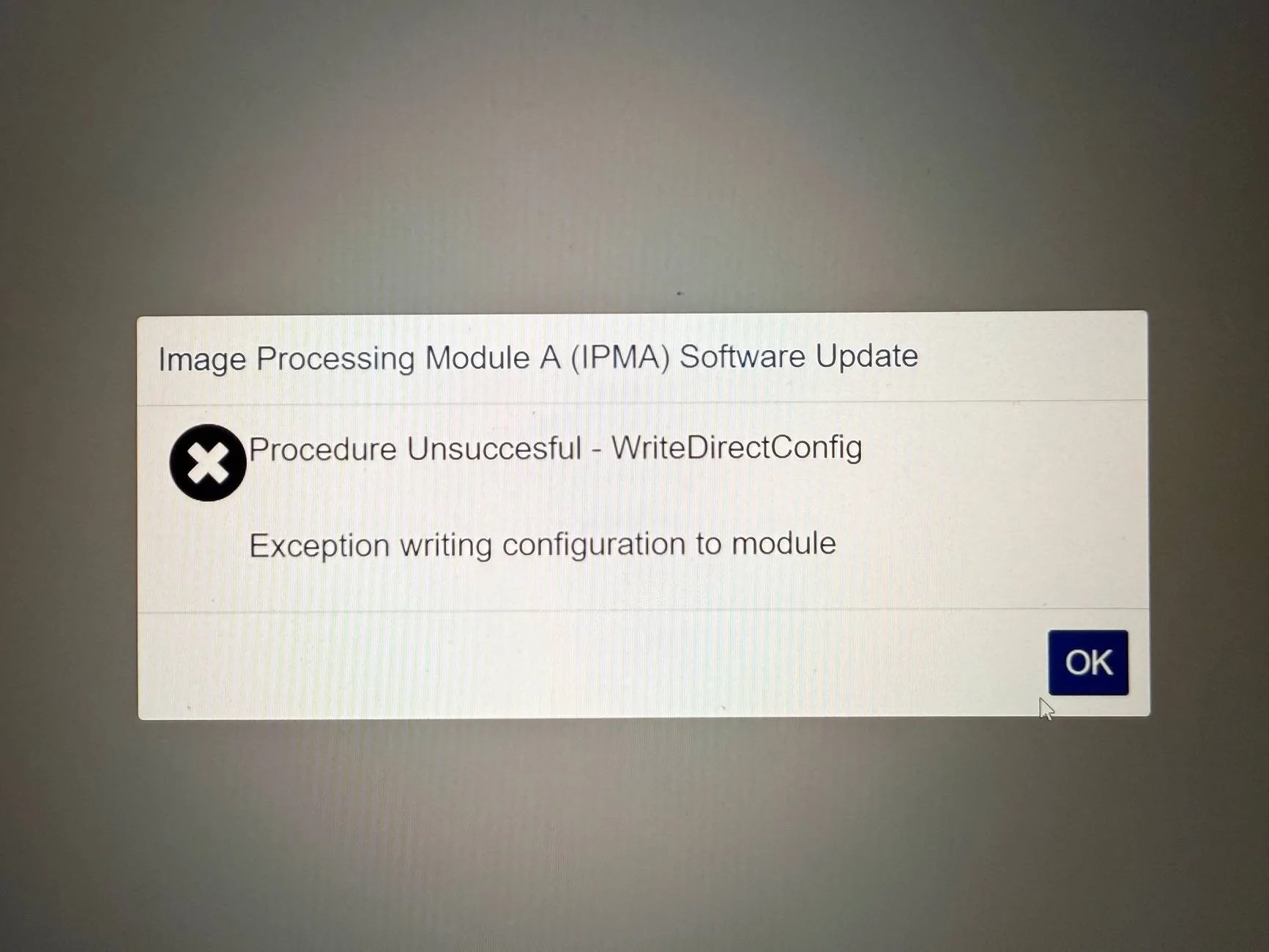

Third time trying ipma i got all the way through but got this error at the very end. Please advise.

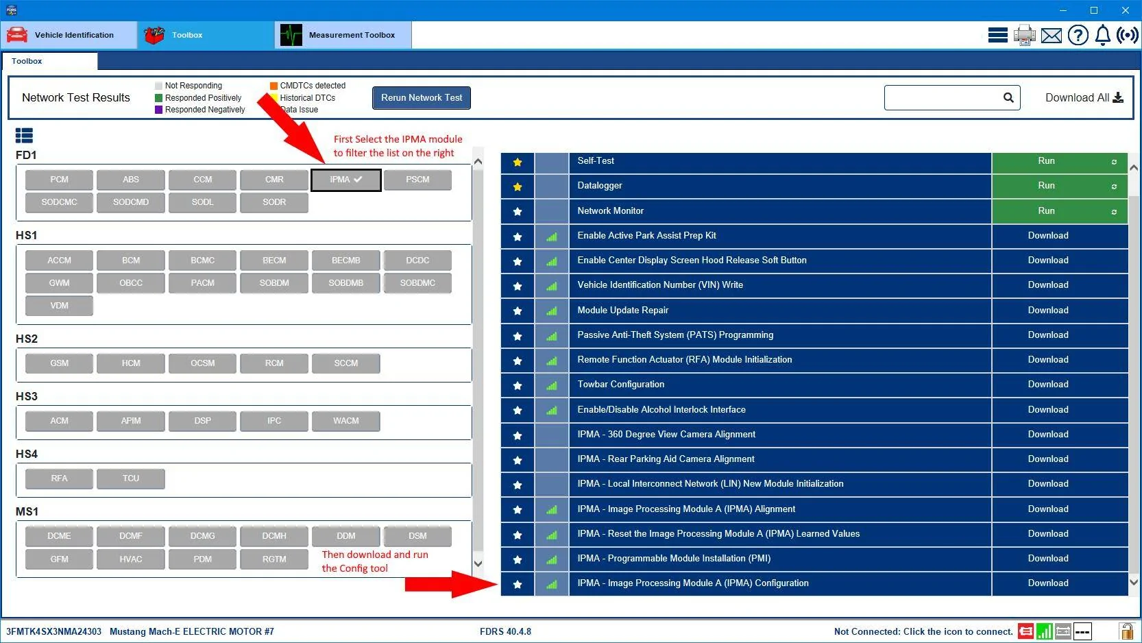

Reconnect and run the IPMA Configuration tool. See if that helps.
Ford F-150 Lightning Lightning Software Updates using FDRS IPMA_Config_tool
If that ran successfully am I good? It only took about 60 seconds and I didn’t get any errors so I’m assuming it worked.

Is there still an IPMA and PSCM in your available list?

After running the IPMA Configuration tool, and the test, I tried re-running PCM even thought it said it completed successfully and it cleared the last error.

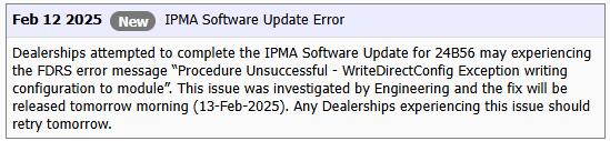

For those who've struggled with the IPMA update issue...
Ahhh....the wheels of progress...amIright?
Ford F-150 Lightning Lightning Software Updates using FDRS IPMA_FDRS_Config_Fix

FDRS got a minor update yesterday from 43.6.3 to 43.6.5.
Here's the link to download the update. It's a minor update so no need to "Remove User Data" during the setup.
This update added a form that dealer techs need to fill out to prove that they did the software updates that whatever FSA they were working on said they needed to do. An anti-shenanigan verification procedure.
