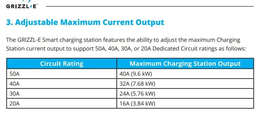

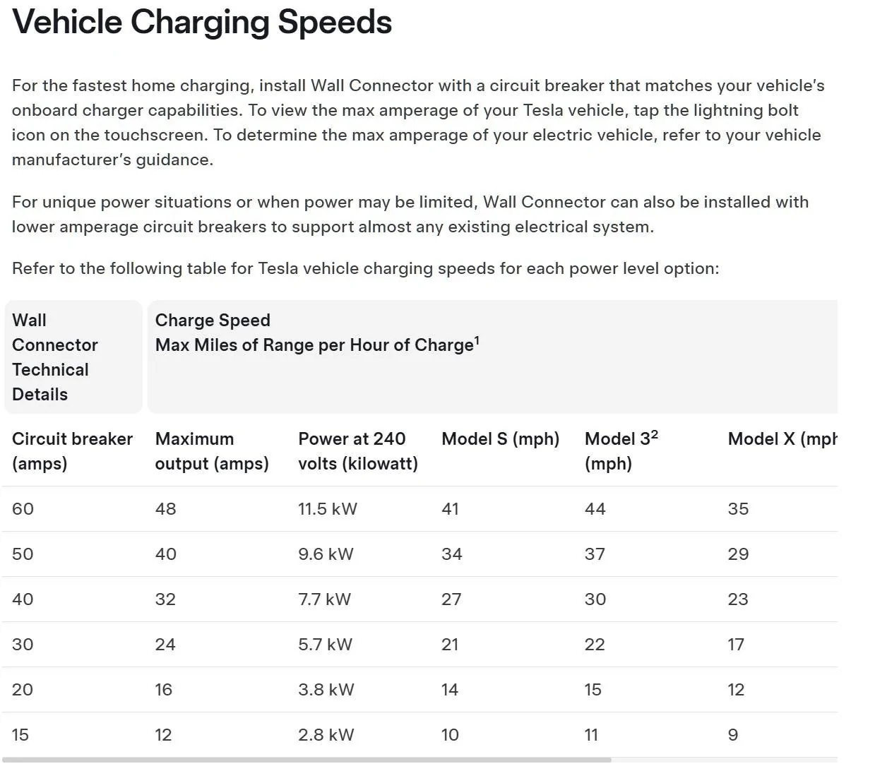

I thought most had this capability...in my experience, the Grizzl-e can be hard-pinned to voltage while the Teslas are a software switch.
Here's an image from Grizzl-e
Ford F-150 Lightning Looking for a charger I can contol my charging rate with Screenshot 2025-07-01 075454
Here's the settings from Tesla wall connector (website showing settings)
Ford F-150 Lightning Looking for a charger I can contol my charging rate with Screenshot 2025-07-01 075806

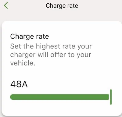

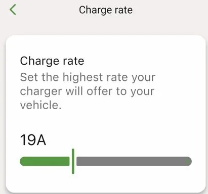

I love my Emporia and use the app to change the charge rate regularly. By default I keep it at 20 amps but dial it up any time I need juice in a hurry.
Edit: I just confirmed that the lowest setting is 6A (at 220v).
2,493
3,467
+1 for Emporia. The app makes it super simple to change the charge rate in 1-amp increments from 6-48 amps. You can even change it while charging if you need to.
Amps = Watts/Volts so 3kW (3000W) would be about 12-13 amps @ 240 volts.
And FordPass notices the charge rate change and adjusts the end time estimate.
