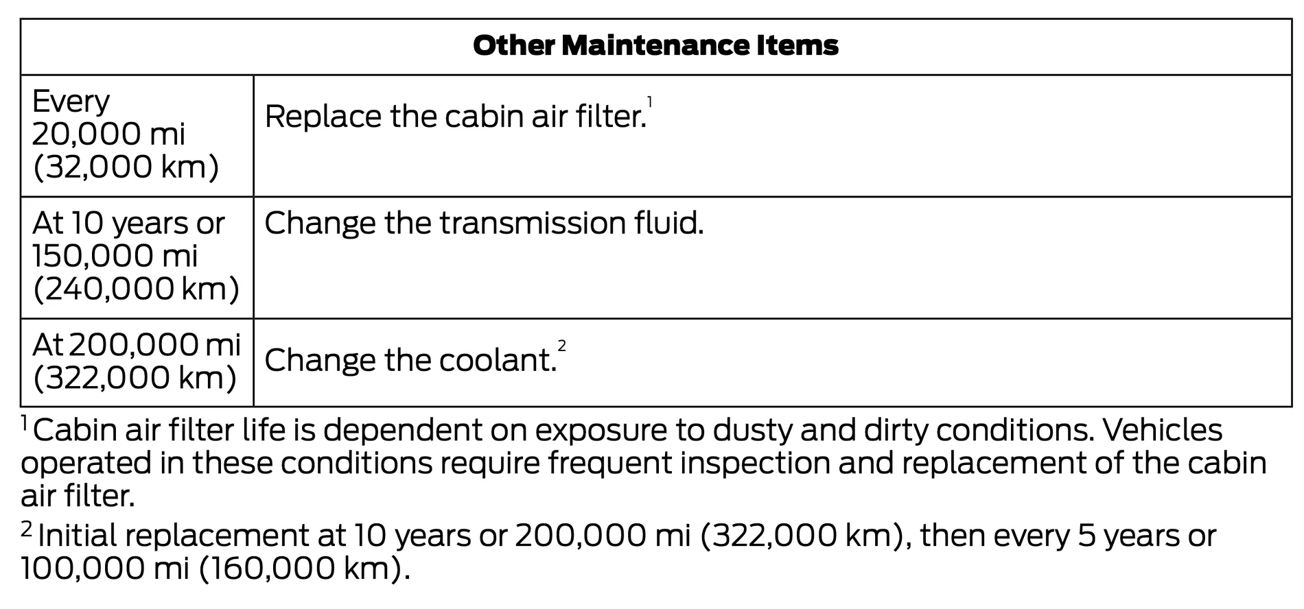

The manual has this, as well as FordPass, and the Ford.com website when you log in.
At 20,000 miles, rotate and cabin air filter.

I got this from a dealership - basically takes the recommendations in the owners manual and puts them in one place:
Every 20,000 to 30,000 miles
  • Cabin Air Filter Replacement: Replace the cabin air filter to ensure clean and fresh air circulation inside the vehicle.
  • Fluid Inspection: Examine essential fluids, such as brake fluid, windshield washer fluid, and coolant. Top up or replace fluids as needed.
  • Transmission Fluid Check: Inspect the transmission fluid to ensure proper operation and efficiency.
  • Coolant Flush: Perform a coolant flush to maintain the battery and electric motor's optimal operating temperature.
My 2023 owner manual does not indicate coolant flush until 200,000 miles. If you’re paying for that every 20k miles, you’re being bilked and probably causing damage to the cooling system.
20k miles is an air filter replacement plus the normal 10k mile inspections and tire rotation.
