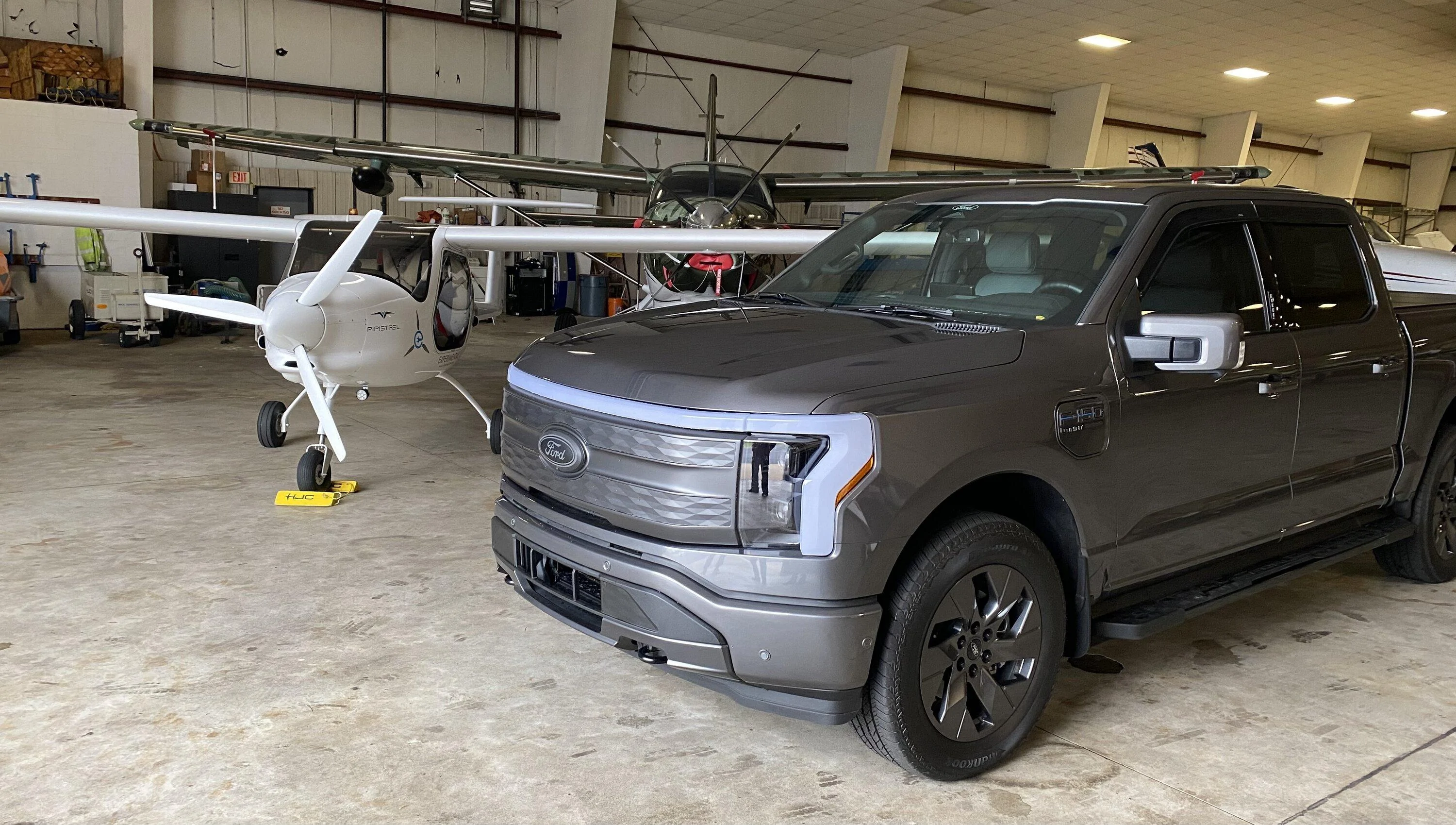

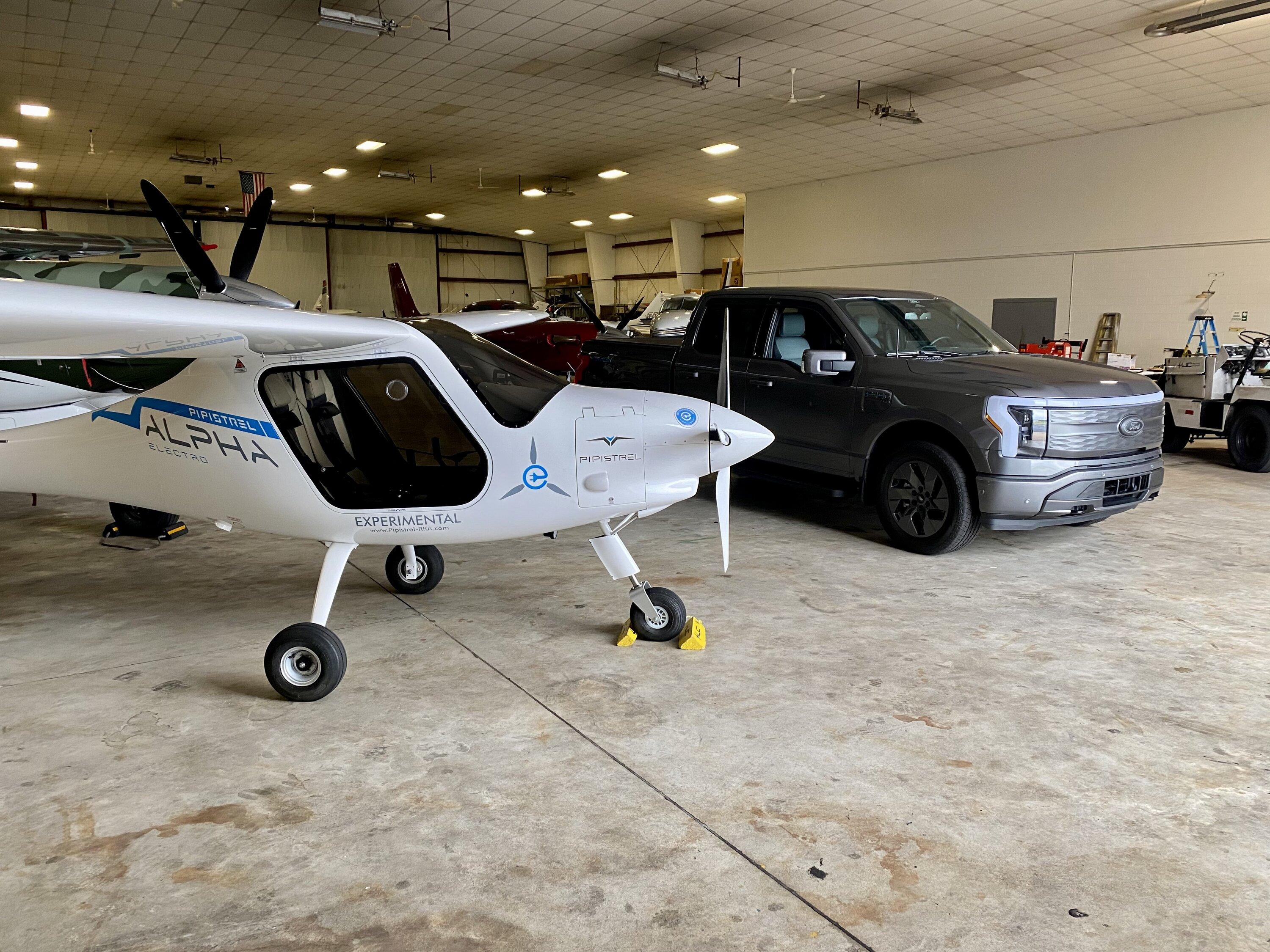

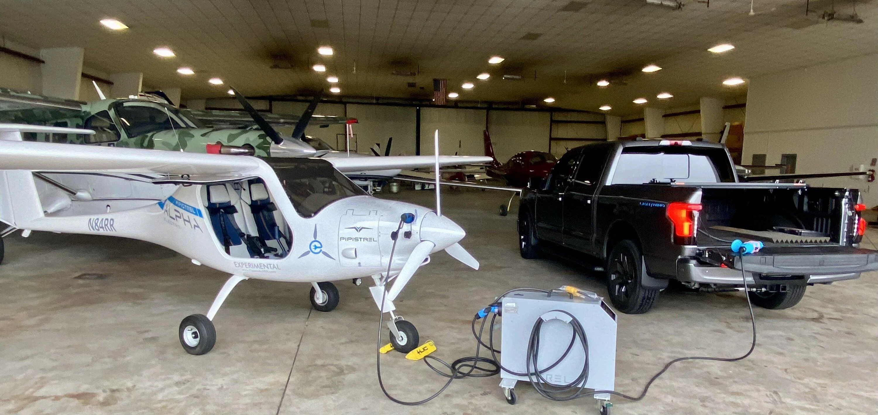

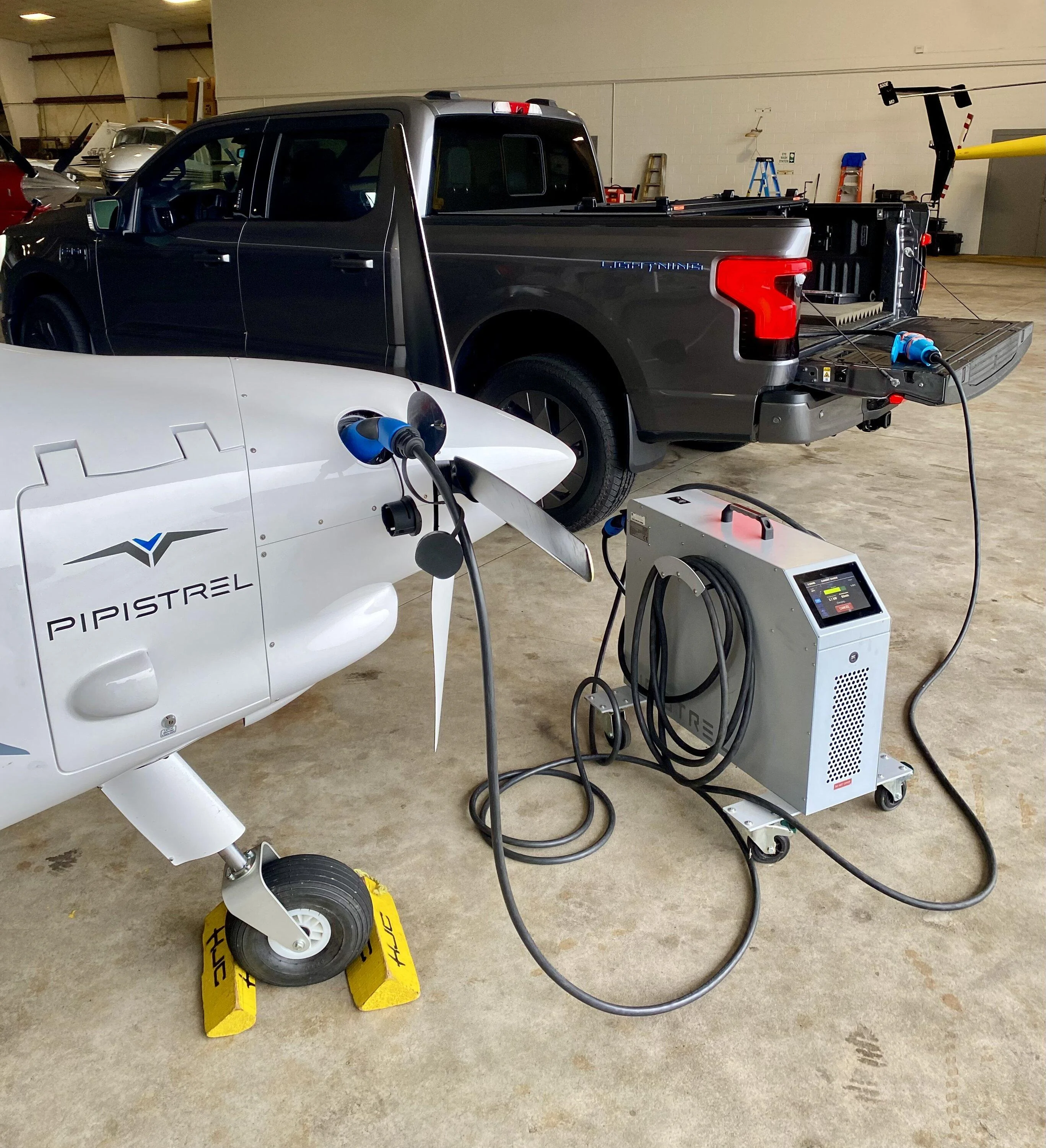

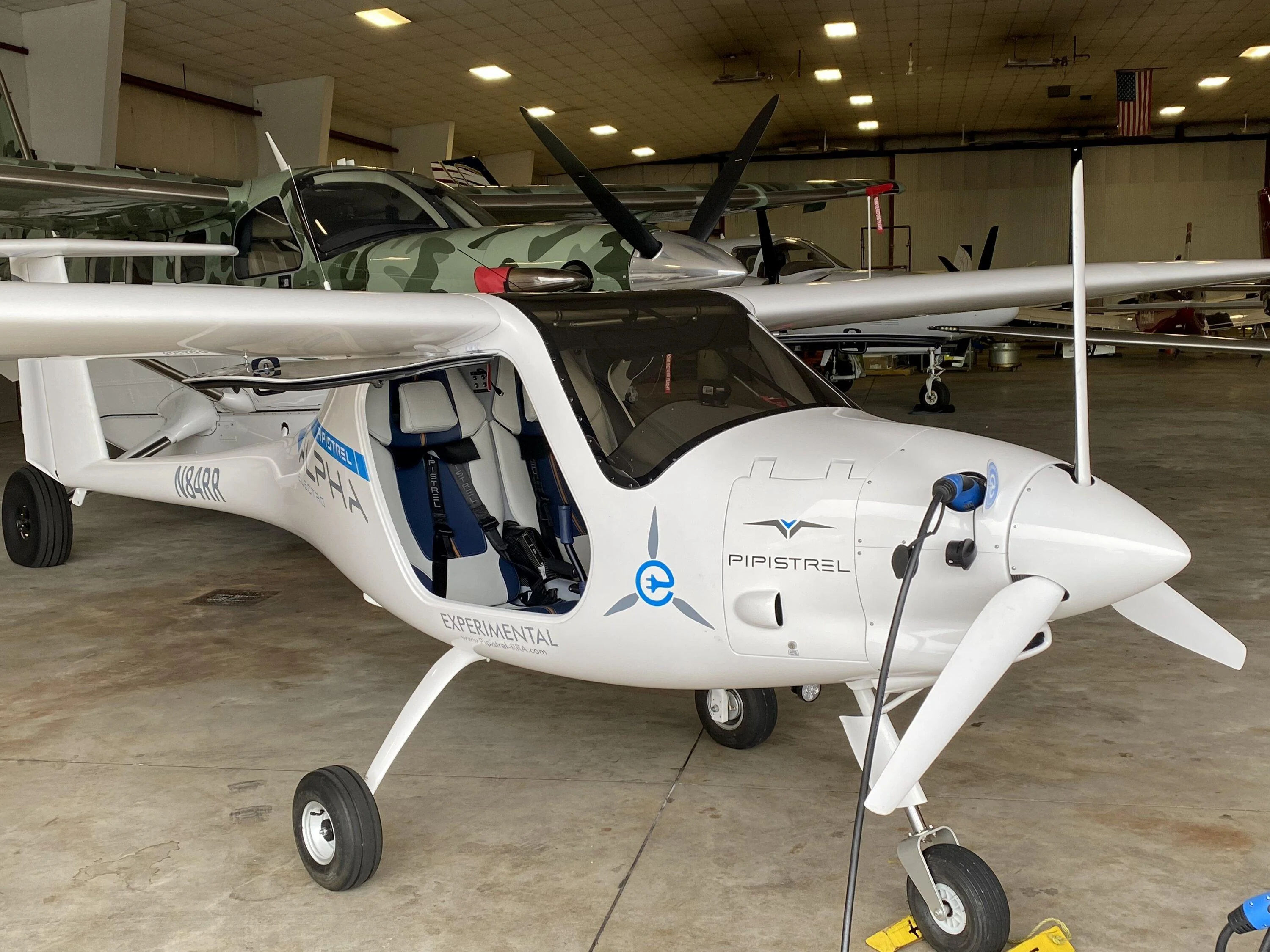

Not sure if this has been done before. An electric truck charging an electric plane.
Helping out ROKTAY on a project he is putting together and he needed to see if a Ford Lightning could charge this Pipistrel Alpha Electro plane. The tests and charging were a success. More to follow in a few weeks. Enjoy

Do you know what that box is doing? Just monitoring the juice flow? Or changing it?

It is a charging box from Pipistrel used to charge their planes. I don’t know if it’s changing anything or just monitoring the electrical flow.

Basically that’s their charge station pro, does the same thing. Obviously they’re only concerned about saving weight on their airplane ?

It's an AC-DC converter going from 240V AC to about 360V DC. @trev5150 is exactly right, it's a weight saving measure. This device is built into all EVs as it's what allows us to do level 1 and level 2 charging but Pipistrel made it external for the plane to save the 150lbs.
