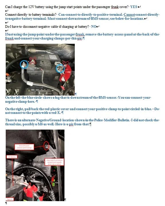

When hooking up a trickle charger to the Lightning 12v, what is the optimal location? Directly to the battery or somewhere upstream before the 12v BMS?
Negative would be downstream of the 12v BMS...see pic:
Ford F-150 Lightning My first Error Code: Fix? post 33 & 38 where to connect neg for battery charger-info
If you are not downstream of the BMS, the system won't know that you charged the battery.
Also...If replacing the battery, have to recalibrate the BMS:
LVB BMS reset
Make sure 12v battery is fully charged (drive an hour, or after an hour actively charging the HVB)
Start Accessory mode
flash high beams 5 times
step on brake pedal 3 times
red battery icon on dash should flash 3 times
If the dealer changes the 12v battery, they should do this, but they don't always. If they plan on keeping it overnight, there is a good chance they will - Just ask when you pick it up.

According to the people that designed and built your truck the ONLY place you should connect any kind of charger or jump starter is under the passenger side frunk panel.
They put that remote connection point in for safety reasons, hydrogen gas can escape form that 12v battery when charging so you want to stay away from it as far as possible when connecting these items as a spark could set off a reaction that's not conducive to the health of man or machine. See Pic below for proper 12v battery charging connection.
Oh boy...unfortunately the designers of the truck put those jumper terminals in a very inconveniently located place where you have to open the frunk and remove a plastic cover every time you want to trickle charge your truck, which should be all the time when not in use for battery longevity...and they are made for attaching clamp-type jumper cables, not made for attaching a standard ring terminal wire.
So yes those are good for jumping another vehicle or your truck in an emergency, but not great for mounting a more convenient easy to access permanent wire for a trickle charger, although a at least one Lightning owner did mount one so he would not have to remove the plastic to trickle charge.

Yes, don't be stupid and attach the wires with a trickle charger that is live in case your sealed battery has some flammable gas that vented.
Although many trickle chargers nowadays are "spark free," not all are.
And of course don't be careless if you are attaching a ring terminal and nut to the 6mm posts with a metal tool (wrench) so you don't accidentally cause a short!
And use a trickle charging cable with a fuse in case the wire gets damaged somehow.
If you mount an SAE socket like many people have done safely you could use something like this:
https://www.amazon.com/dp/B0BQ3N1N6Z?ref=ppx_yo2ov_dt_b_fed_asin_title
While many Lightning owners have added a convenient trickle charger connection to their trucks without incident, if you are a complete klutz, have your local service station auto mechanic install it...they should be able to handle it.
See all the examples at this forum link:
https://www.f150lightningforum.com/forum/threads/charging-12v-battery.16979/#post-342839
