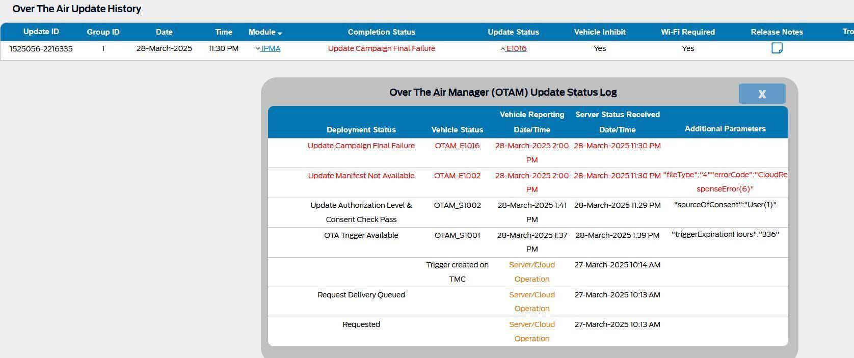

Going on two weeks since the 1.4 download failed on my truck. The error stayed on the update screen until yesterday when it was replaced with a notice that the window update had downloaded. I hit the button to update it, turned the truck off and locked it. Came out in the morning and it had installed fine. I’ll post again if 1.4 shows up.
I know the answer is probably "it varies", but does anyone know how long it usually takes for Ford to re-try an update? Haven't seen anything since 1.4 failed on my truck the first time.
My 1.4 update failed on 3/29. No update attempts againfrom ford until 4/9 when they sent the window update. Then yesterday, two weeks after the first time they tried to send 1.4, it showed up again. This time, the download succeeded and it installed overnight with no issues.

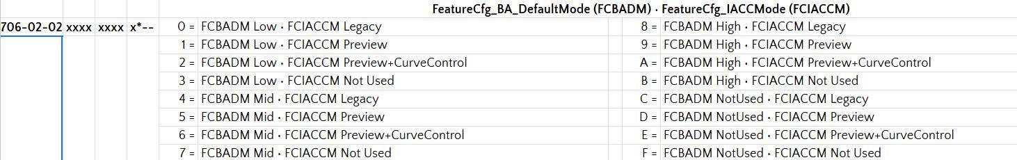

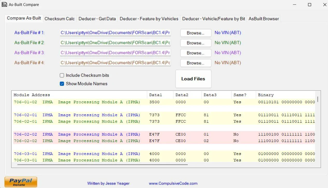

Well, I compared the before and after values in the IPMA and PSCM and found one change for 706-02-02 which appears to have re-enabled the annoying curve control after I disabled it previously. Guess I'll see if it behaves any differently before disabling again but not going to hold my breath.

To install BC 1.4, I would think the OTA needs to update the modules AND do the AsBuilt configuration to enable all BC 1.4 features. I.e., the same steps as someone doing it with FDRS and FORScan. Makes sense those values were written over.

Thanks @PJnc284 for checking on my error. Has anyone seen this type of error on the BlueCruise 1.4 OTA update? Some history, I updated my truck with FDRS on March 21st. The update included the lengthy IPMA module. The OTA error indicates a file type 4 errorcode.
It took a couple of weeks but Ford seemed to fix it over the weekend. The update went in last night so I'll be testing BC 1.4 this week.
