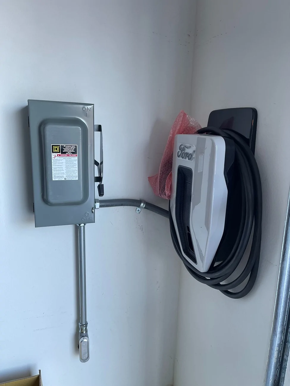

I have FORD Pro installed on a 100 amp circuit that gives 80 amps.

Do you have any way to verify that the Ford Pro charger is offering the full 80 amps? Other posts about the Ford charger make it sound unreliable at best.
No, unless they is some way to verify via app or on screen. It histically charges really quick when its just regular cold.

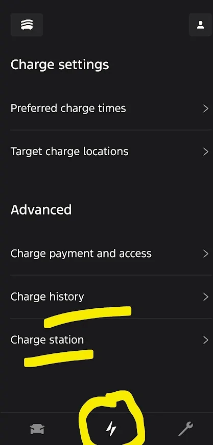

So what happened last night was that your charger didn't deliver 48amps consistently, OR the truck had an issue. You can look at the charging history to see how many kWh it delivered, and when it was charging you could have seen the delivery rate.
Check it for trouble lights before plugging in. A yellow light indicates it is operating at reduced power. Turn off breaker for 30 seconds, turn back on, and see if the light turns blue.

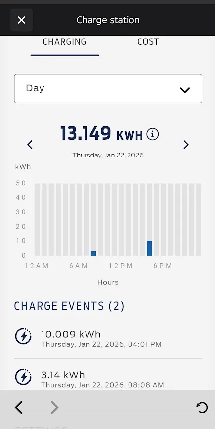

Show us your charging records.
Ford F-150 Lightning No Full Charge. Too cold 1769185623706-8r
Ford F-150 Lightning No Full Charge. Too cold 1769185647068-7t
Ford F-150 Lightning No Full Charge. Too cold 1769185671106-rt
