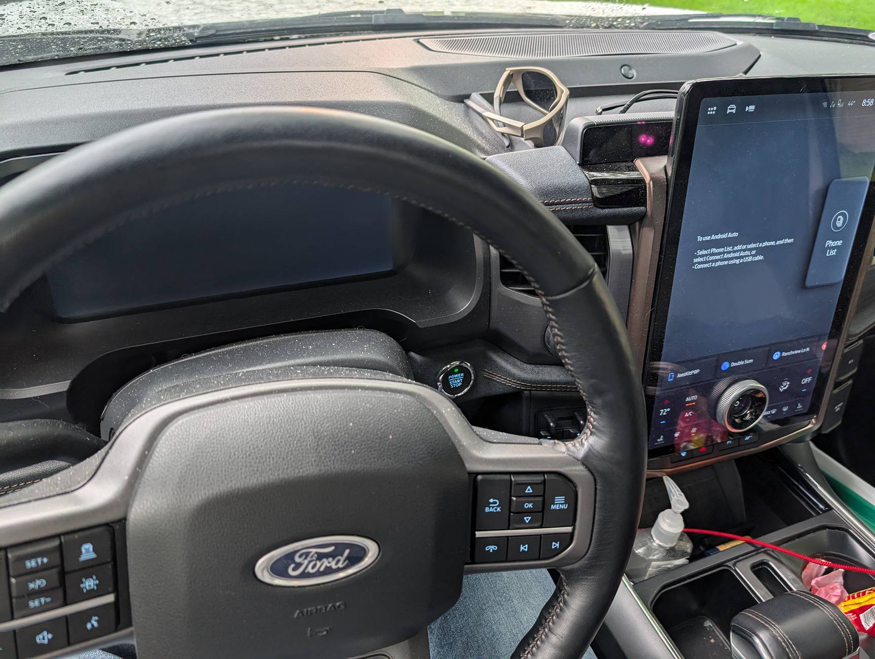

My odometer screen is blank this morning. It seems to be the same thing described in the post I linked below. This sounds stupid but I didn't notice until about a mile from my house (I was screwing around connecting my newer phone) so I can't say if it turned on at first and later cut out.
https://www.f150lightningforum.com/forum/threads/lost-my-speedometer-screen.14158/
I pulled over to try turning the truck off and opening the door, but no luck. I pulled out my ODBII dongle and set my phone to show me speed and I continued my commute. It stayed the same the rest of the drive.
I'm hopeful that it just fixes itself like in the post above, but am leery about intermittent issues. Has anyone experienced the same thing and found a definite fix?

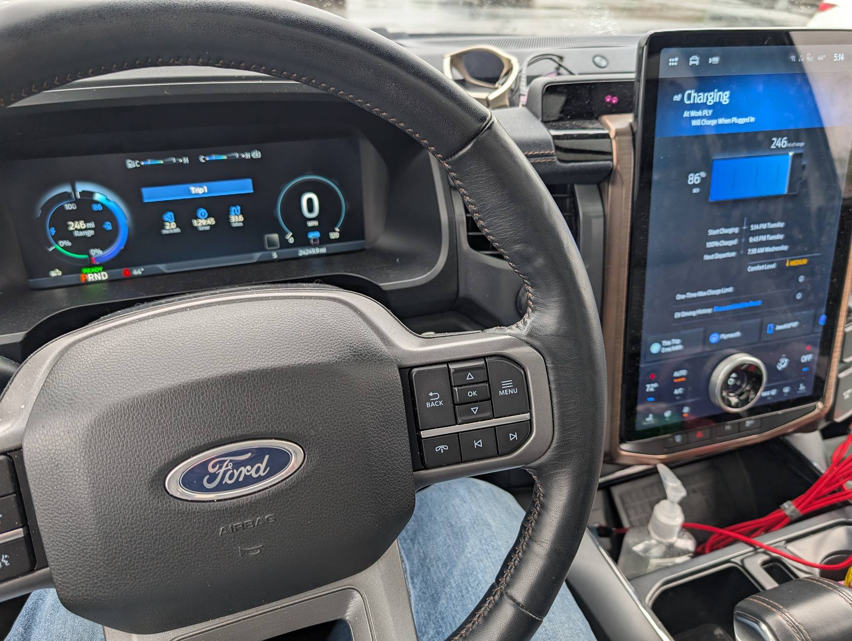

As luck would have it it's back online. Parked it at work and was restored when I left at the end of the day. Hope not to see it again for at least another 24k miles.

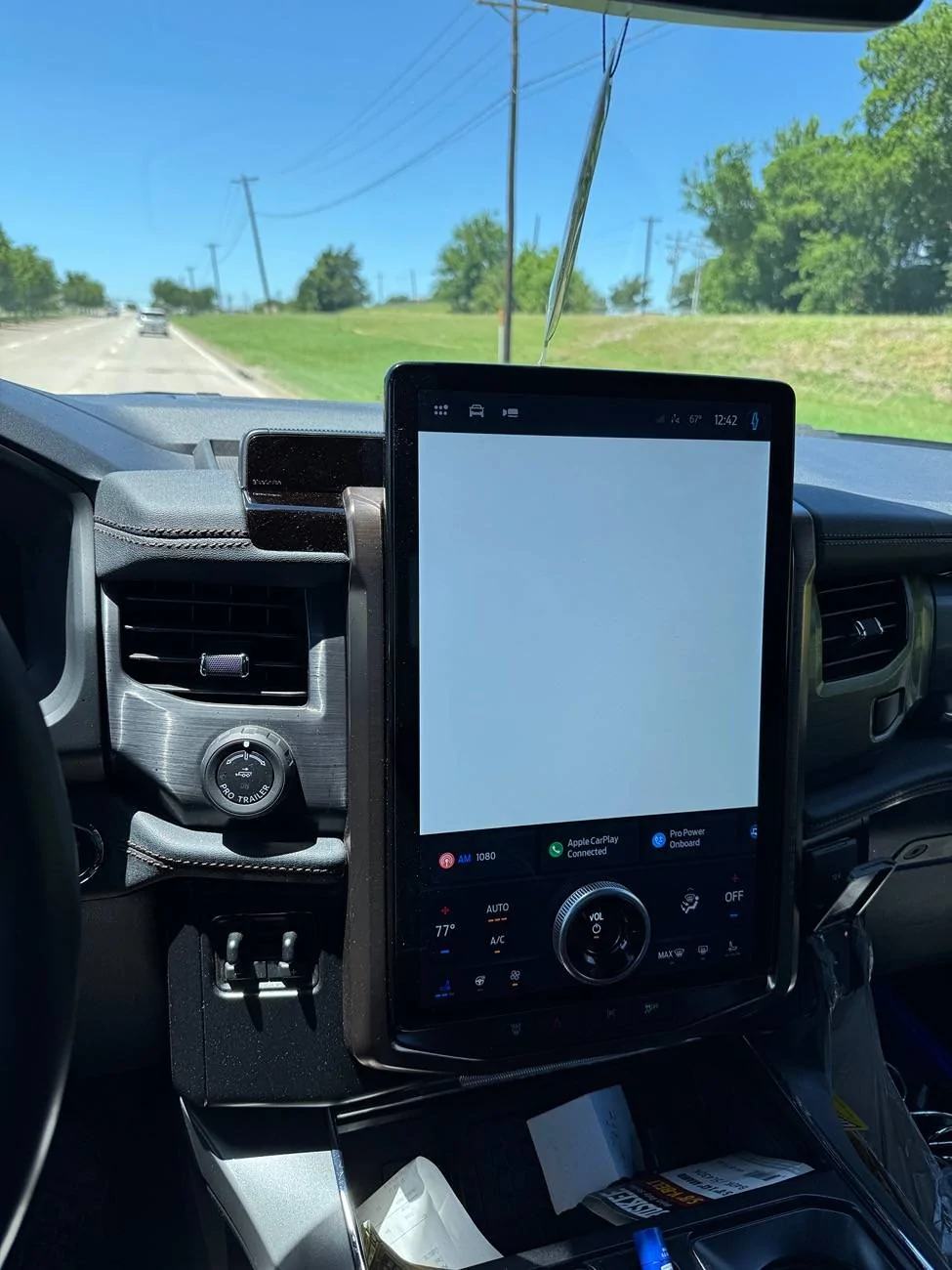

I know it is the other screen, but I had this happen today when I told Siri to call my dad:
Ford F-150 Lightning Odometer Screen Blank/No Info IMG_1566
It came back up after I ended the call, but that was quite weird. Never had that happen before!
