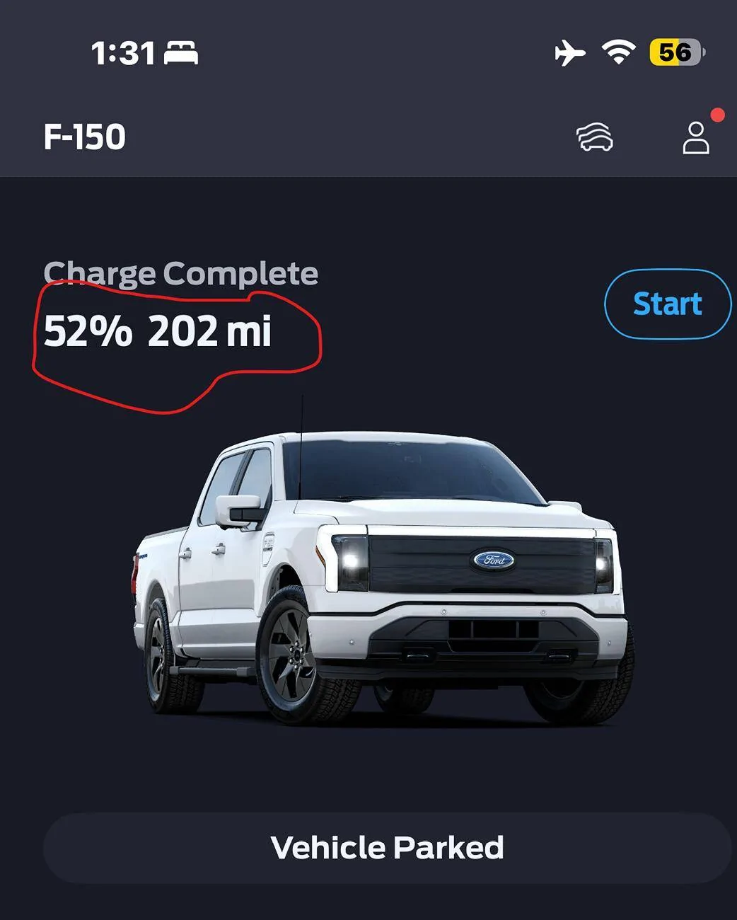

Another weird thing in FordPass post PowerTrain update. Not only will the truck charge at higher rate, but I can drive forever according to the guessometer! :D

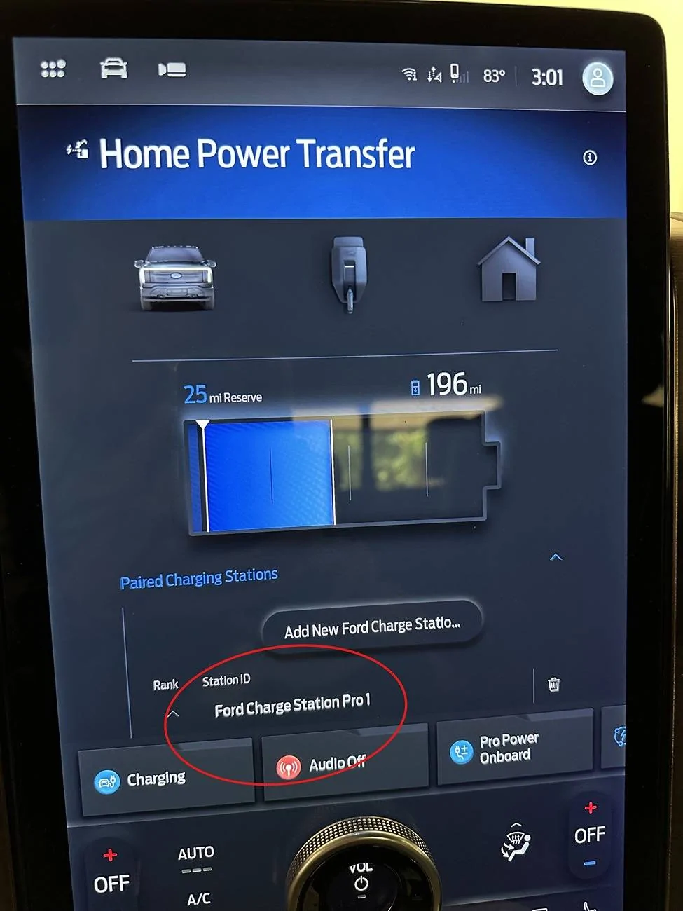

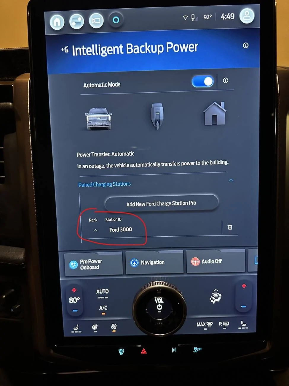

Some evidence that the 10.3.0 Powertrain update revamped the truck-FCSP BT pairing scheme: the name of the paired FCSP is different now in my new pairing. The wording and design of the Intelligent Backup Power SYNC screen is different, too (although I may have capture the screen in different states in the two pictures, without paying attention....).
Ford Charge Station Pro1 in new pairing

Ford3000 in old pairing
The Bluetooth change is from a firmware update of the FCSP a couple months ago, not the 10.3 software. I did not have to redo mine in 10.3 but mine was already set to FordChargeStaionPro1 from when I reset it back in March/April.
That being said I think there is something in this update related to HIS. It can’t be coincidence that this weeks reports of getting this all have the HIS.
