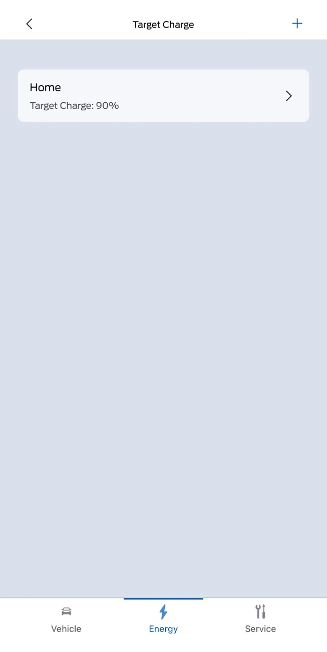

Maddening. Even after I charge again, no recognition of location. I have charge history in the app, but ZERO charging locations to choose from to set schedule or charge level.
Nothing in the truck or the app.
IOS 5.11

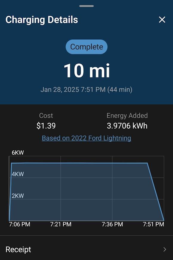

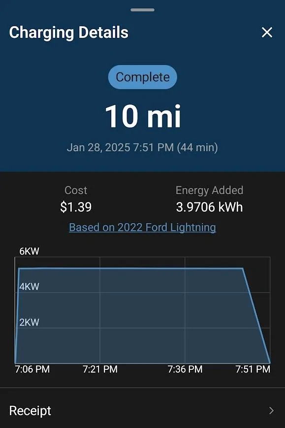

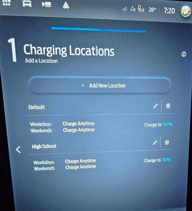

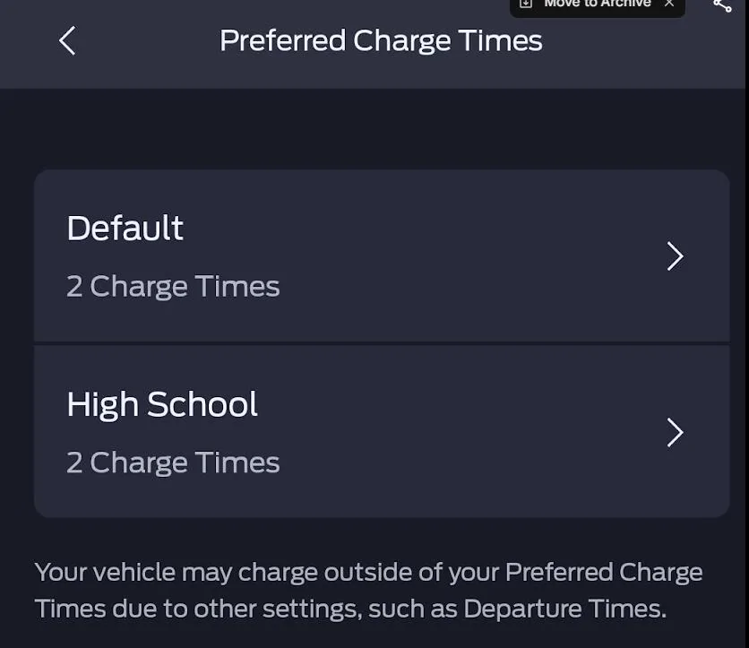

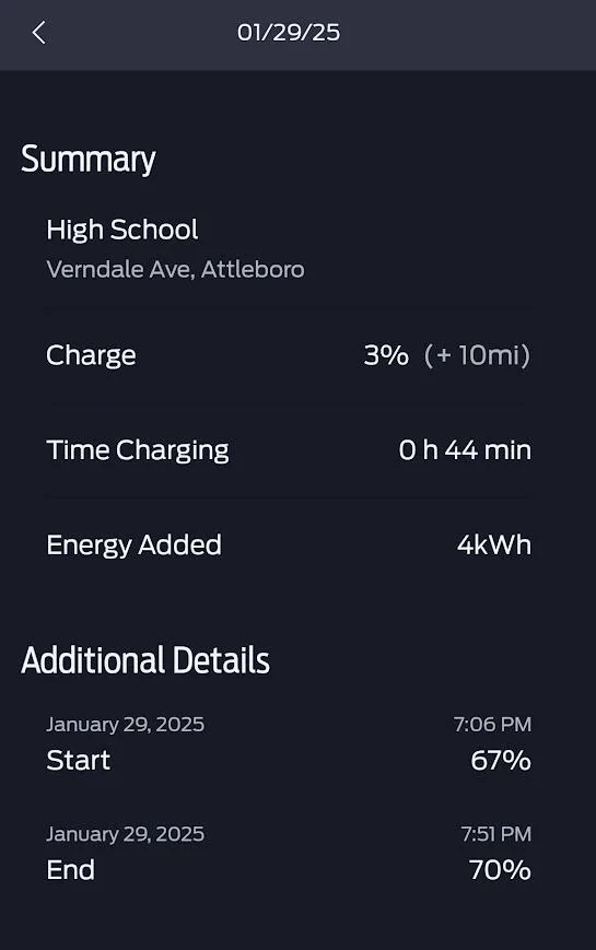

Confirmed that I could build a charging scheme at a new location, our local high school has 6kw level-2 facilities spread around the campus, I plugged in, and let the session run, I tried immediately adding a new charging location, it refused, telling me I needed to complete a charging session at the location.
Waited about 10 minutes, then tried to add again, while the session was still active, it worked, I was able to create a SOC limitation and save to Fordpass, a second or so later it displayed on the Sync screen
Ford F-150 Lightning Did OTA 10.3.0 Remove Charging Locations? 1738115181348-2
Ford F-150 Lightning Did OTA 10.3.0 Remove Charging Locations? 1738115247040-kt
Slow & cold session 3% that I burned off by the time I got home LOL

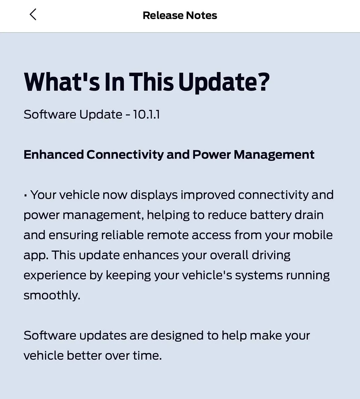

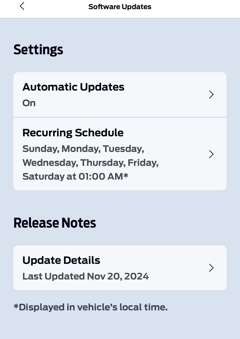

10.3.0?
I have automatic updates turned on and last update received was in November 2024??
10.1.1???
How do we force an update??
You can't force an update. And 10.3.0 was paused because it caused issues with charging locations.
Some users get updates before the general public as beta testers. In this case, a problem was contained before it got to everybody.
211
15,622
17,460
10.3.0?
10.1.1???
You've been with us nearly a year, haven't you figured out that we have ZERO control over what the "FORD' shall desire we receive?!?! Pull up a seat on the second stringer bench and wait for beta testing to finish, BTW, if you look at the 10.3.0 update thread ..... it's PAUSED because of a bug!
