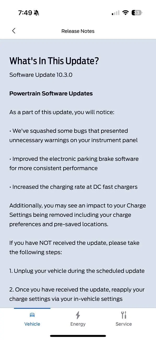

I just received this update this evening.
Ford F-150 Lightning OTA Software Update 10.3.0 - Powertrain, Battery, Parking Brake IMG_2496

I just got the 10.3.0 Powertrain update when I turned on my truck this evening. It erased my charging location, target charge, and preferred charging times. I removed my vehicle from FordPass and then added it back again. I briefly charged and added those settings back through the truck SYNC screen, set up phone-as-a-key again, but >90 minutes later, the charging settings have yet to reappear in FordPass, which I also updated from the iOS App Store to v5.21.0.
Was your charge cable plugged in when the update occurred?
I didn’t lose any settings but I did the update manually before I plugged in to charge.
No, I unplugged my charging cable before I allowed the update to run. My settings were cleared from both the truck and FordPass.
Still no settings in FordPass this AM. Time to delete vehicle again, uninstall, reinstall FordPass, etc?
Before resetting everything, I would verify that the app is actually getting proper updates from the truck (or that the truck is updating the cloud server properly). I would turn the truck on, and make sure the appropriate icons (usually wifi symbol and up/down arrow symbol) are on then just refresh the screen in the app first.
For instance this morning my truck is not updating anything. It just shows the cellular bars icon, and according to the app is still waiting to charge (which is the state from about 8:45pm last night). While this is a very common occurrence for me, maybe it happens every so often to others as well.
To be honest it doesn't really matter if the app shows the charge location / times correctly as it only matters what the truck itself is doing.
