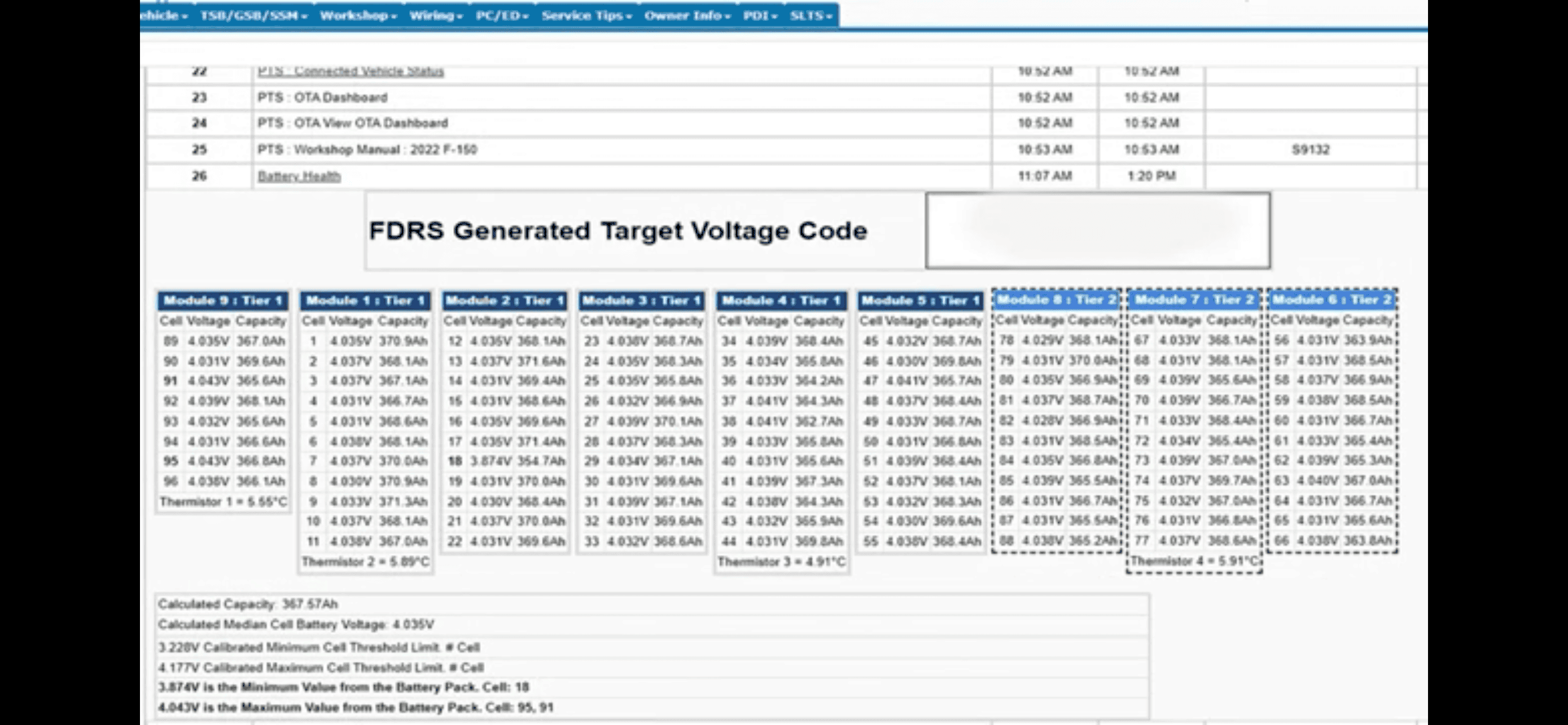

However doing things at cell level may not be always as expensive as you think. Tesla has a fuse for every cell (just a thin wire). And looking at the attached info, although Ford is not watching every cell, they are watching every five sells. In fact, that means the backup batteries are already baked in. If every 5 cells are in parallel, taking out the bad cell by blowing out a fuse will stabilize the voltage for that group without the need to do anything to the pack. The only thing is the total energy is reduced by 0.2 % which is hard to notice. You can do this three more times for the same group without needing to open up the pack. Which means you may never have to fix the pack for the life of the vehicle due to cell problems.
Just shooting off potentially more stupid ideas: If a bad cell has higher voltage than others, could we blow out it's fuse with a hard acceleration? Meaning push slightly more current through a sensitive fuse (like what Tesla has but with smaller tolerance) beyond its limit and take that cell out of business? Not sure how much of a problem low voltage is and how to take those out.
I know how all of this sounds from someone that does not know what he is talking about, but I have faith that someone that is in the right field (may be biology) can come up with a smart way to blow out the fuse like nature does with most of it's operations; Smart but without a microchip.
Ford F-150 Lightning P0B24 Voltage Unstable Cell_V

If I remember what my service technician told me correctly, if a single cell’s voltage falls 0.03 volts or more below the nominal output of 4.03 volts, the truck goes into reduced power mode. On my truck, the voltage in cell #96 in Module #9 dropped to 3.97 volts. Not much of a drop, but still enough that Module #9 had to be replaced with a new one.
