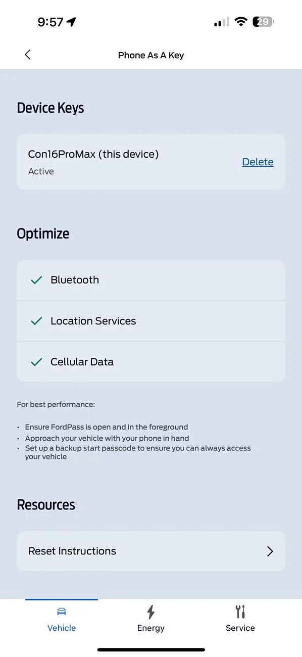

I must not know how to use PAAK. As the truck ALWAYS has me type in my code in order to start the vehicle. You guys make it sound like the phone is a perfect replacement for the fob. That has not been my experience. Do I need to press any buttons on the phone to start the vehicle (Without typing my code into the Sync4 screen)?
No, it should work just like the fob. You just walk up to the door and unlock and get in and start. You should only need the code if phone is dead or you get locked out of FordPass or something. Check Fordpass PaaK settings it should have checkmarks to tell if you if it is working properly. For example FordPass must have access to Bluetooth, Location, and Cell data.
You need to have your phone as a key enabled and the FordPass app opened and background processes running. Does FordPass look like this screenshot for you ?
