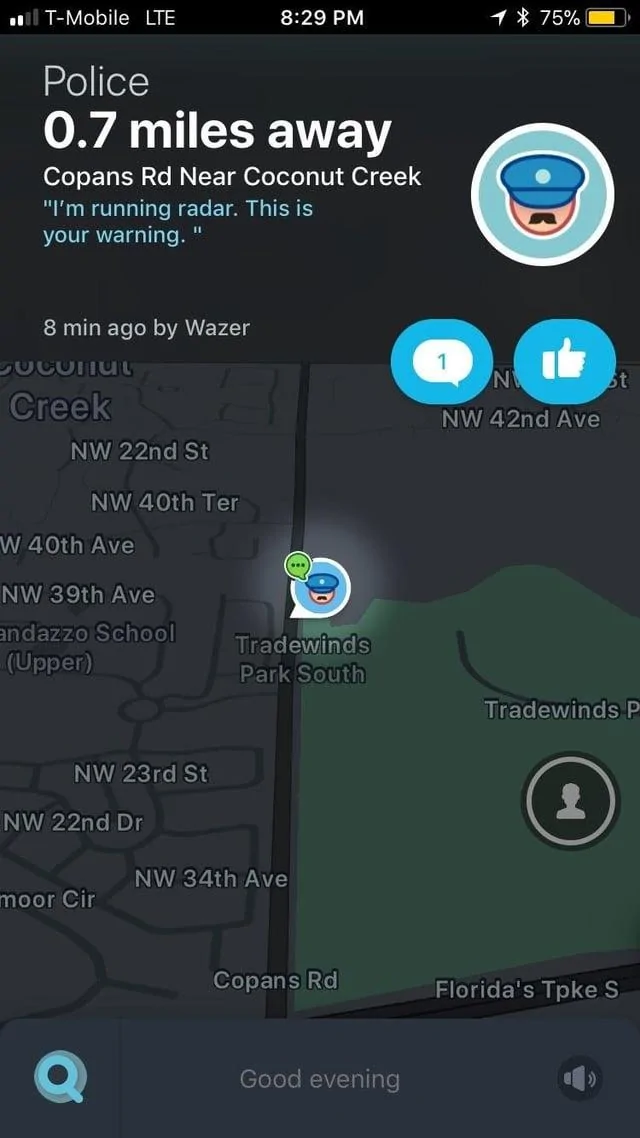

All I got to say is the one time I tried Waze, it took me off a main thoroughfare, directly to police.

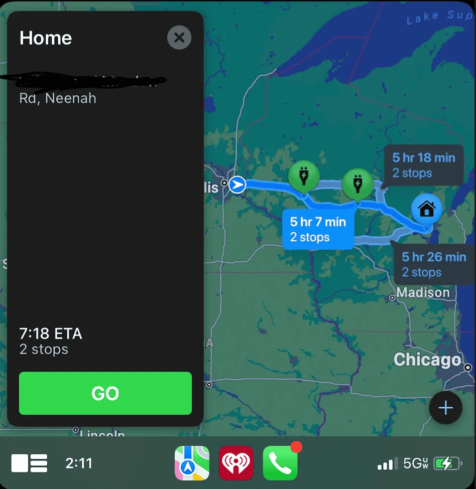

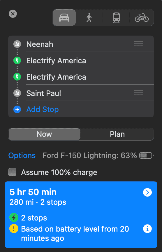

Now that I have Power-up 6.3, I did some more testing.... A few notes from a recent ~260 mile trip (520 round trip) (Extended Range model) from Neenah, WI to St Paul, MN and Back the next day. This time testing / comparing Apple Maps EV trip planning to Ford's.
- Summary, I like Apple's more than Ford nav but it is still near worthless compared to planning charge stops ahead via Plugshare and monitoring MPK and calulating on my own.
Side tangent: if this route planning is the best AI we got, we dont have to worry about the singularity for a long time!!!
- Both Nav system wanted me to stop at 2 chargers (I was around 85% SOC for each initial departure) to make the trip (30 to 40F). I was able to achieve both trips with one Electrify America (EA) charge stop to 80%. I was able to do the trips in ~4hrs driving + ~20 minutes EA charging. About an hour less than each NAV calculated with 2 charge stops. After each of my "1st" charge sessions I was able to get the Nav systems to just get to the destination without a 2nd requried charge stop. (see next bullet point)
- After my charge session, Apple when selecting route on phone did provide me an option to arrive at destination at < 10%... which was nice since my destination (hotel) had charging. That said, on my return trip home Ford Nav also provided me an ability to arrive home at < 10% instead of forcing me to choose a path that redirected me to a charger before going home to arrive at > 10%. This was different than my previous experience with Ford nav... Im not sure if something changed in recent updates? A step in the right direction if so.
- On the outbound trip, I purposely went a different route vs the planned trips provided. I did this for 2 reasons a) I chose more 4 lane highway miles vs 2 lane highway miles due to more deer risk at this time of year as I was driving at night. b) My route would only add 10 minutes and would provide me 2 options for Electrify America stops instead of just 1 incase there was an issue at the 1st.
- Apple figured out that I was deviating than the NAV planned route and re-routed much more seamlessly. Im not sure Ford nav ever figured out that it should switch the route based on my deviations, it just kept trying to turn me around even when it was obviously much slower than the alternate it should have figured out. This would have been a major problem if it was colder and I needed to precondition the battery at the EA charger I wanted to use. Only being able to precondition the battery using Ford's horrible navigation is a problem, we need an option to manually precondition!
- A related question for those that use Ford nav, if you put in a DCFC location as your destination does the NAV system know to Precondition if the NAV thinks that is your "final destination"? or is that what the Charge assist app is supposed to accomplish?
- A little easter egg... When pre-planning on my Mac (or any apple device)... Apple Maps syncs with my trucks last known SOC% which is kind of a cool feature. (see attached screenshot of that)
Note: I have done this back and forth trip twice now with my truck and these have been my first EA sessions and all 4 of my EA charge sessions have been perfect with Plug and charge and good speeds.
Wish: Since doing the mental calculation of range/efficiency is essentially required because the NAV / GOM is so bad, I would actually prefer the remaining kWh to be displayed instead of state of charge % or the option to toggle it for driver profile.
