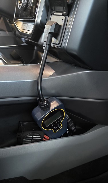

Can't tell if it's hot or not, feels room temperature to me but it also has the fan that kicks on immediately so that's using some power as well. This is the one I use. I like how the timer plug head blends with the interior trim. https://www.amazon.com/dp/B0BTLMNFB1?ref_=ppx_hzsearch_conn_dt_b_fed_asin_title_1&th=1
I'm not referring to hot or cold as perceived by a person two feet away. Two seconds is too short to perceive that. This is about the heating element itself. You can touch it with your finger if you want to know that!
Literally the first thing I did when I got it. It is fast heating according to them but 2 secs isn't long enough, the benefit is the load you get from both the heating element and the fan as they both energize at the same time.
