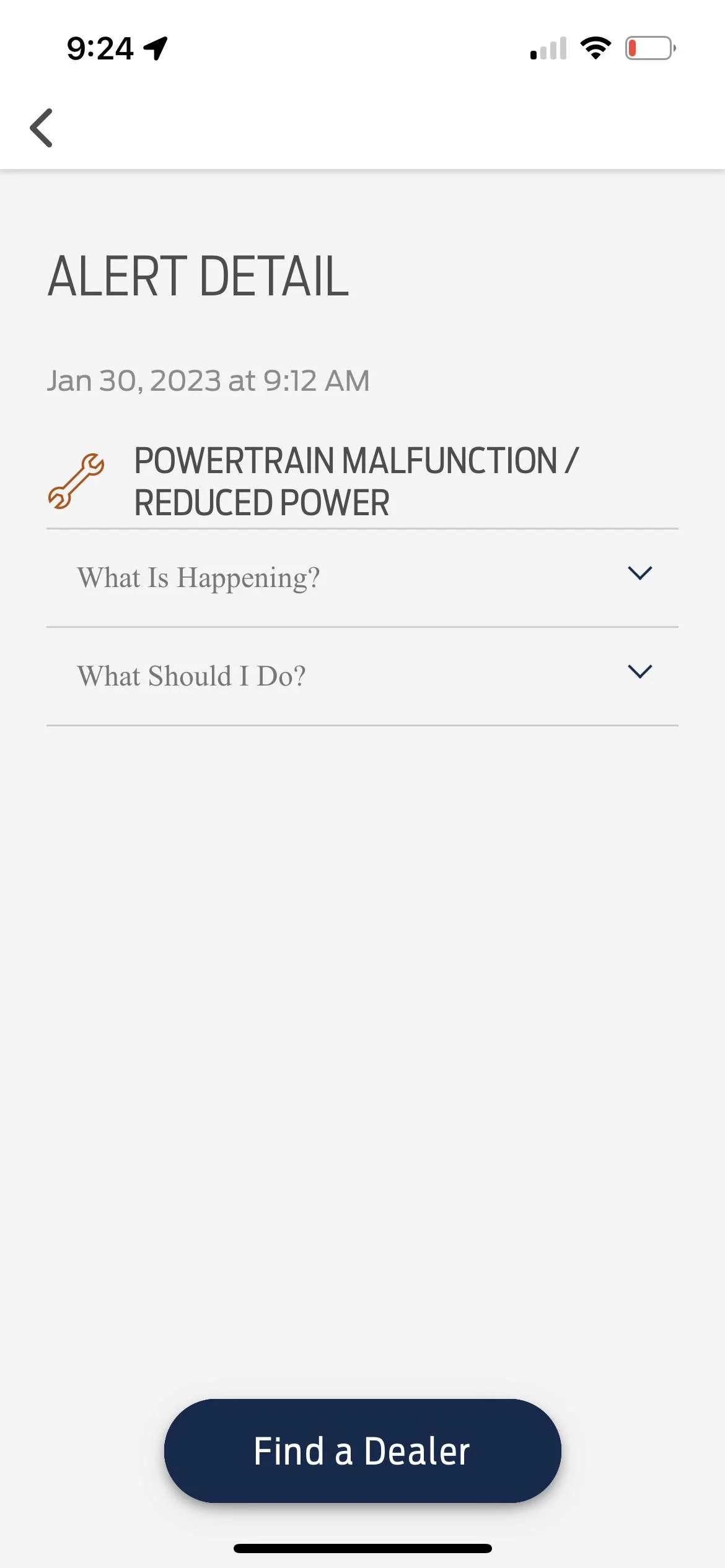

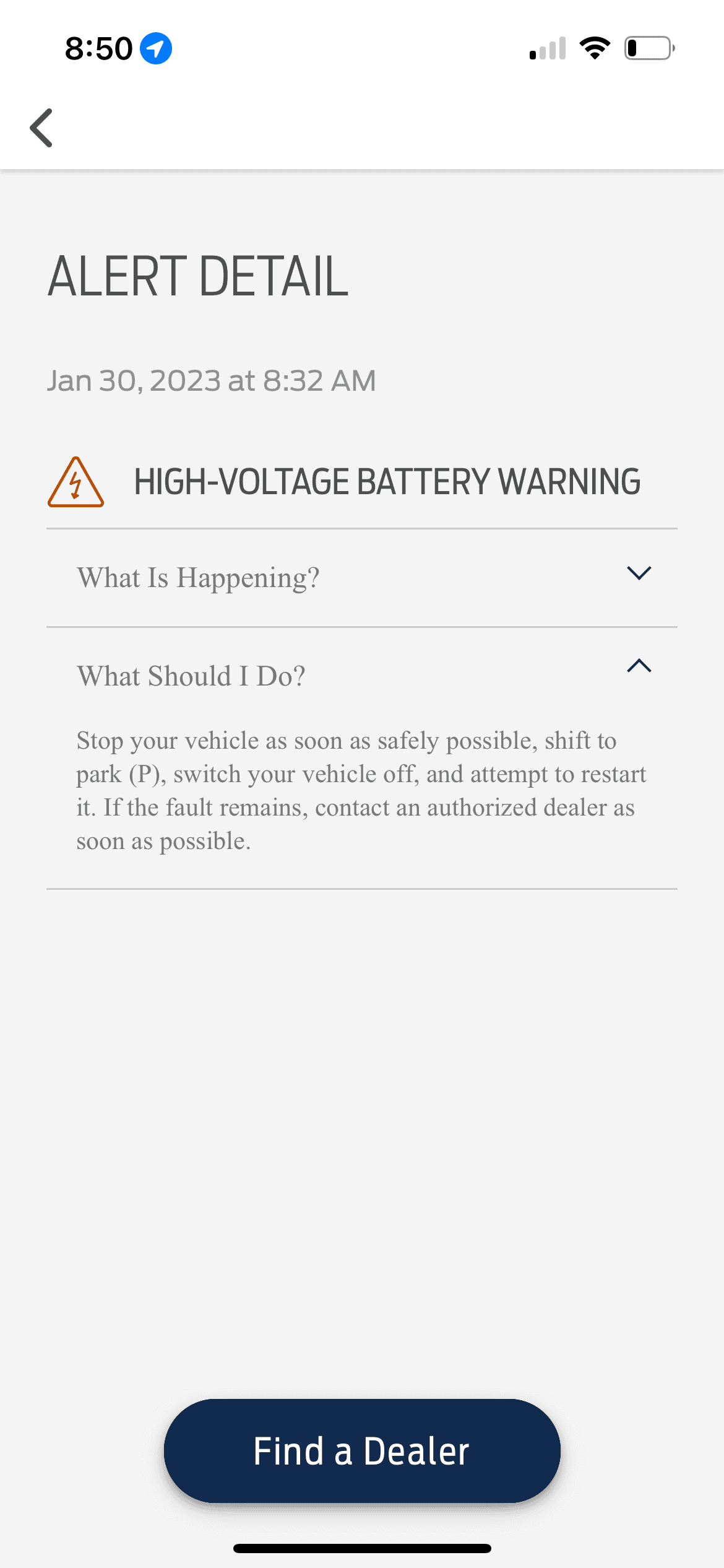

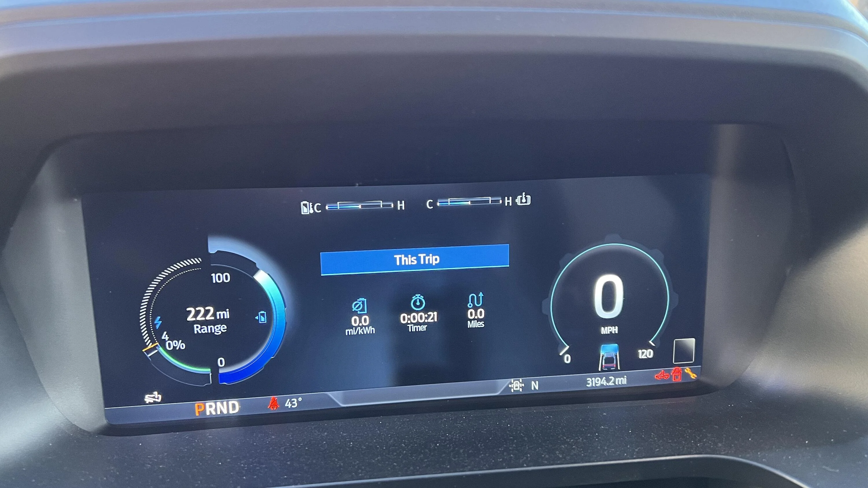

Well, mine failed again today. Last week dealer said they resolved it with a software update and then got call an hour later not to drive it too far as the code will come back and Ford had called them that there might be a bad battery cell. It's back at the dealer again but this time I got the new warning as well for HVB warning. Happy I live half a mile from dealership as I can crawl over there at 8 MPH on backstreets with hazard lights on, but have lost full confidence in the car. At this point it's a 90K lawn mower. Contacting lawyer today to find out about lemon law and my rights in California. Bought car mid September.
