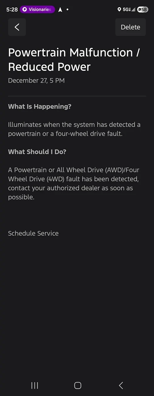

So took a road trip from Seattle to Mt hood and truck wouldn't charge on any charger that I tried. First one the light turned RED which i thought was cause it was a Tesla Supercharger. Then I tried 3 other types all with a ORANGE indicator. Me freaking out with 17% left and 100 miles still to drive, got in to drive to the next and got a Service engine(lol) soon indicator light. Then about 6 notifications on my app. One good thing was that requesting a tow was very easy! Way easier than Teslas was. Now all I have to do ia wait till Monday? Maybe to find out what's wrong.

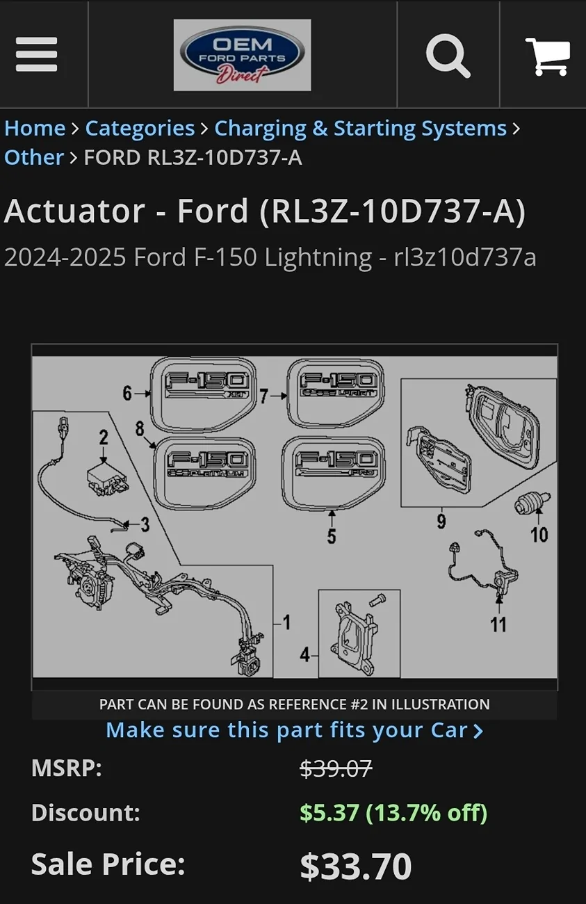

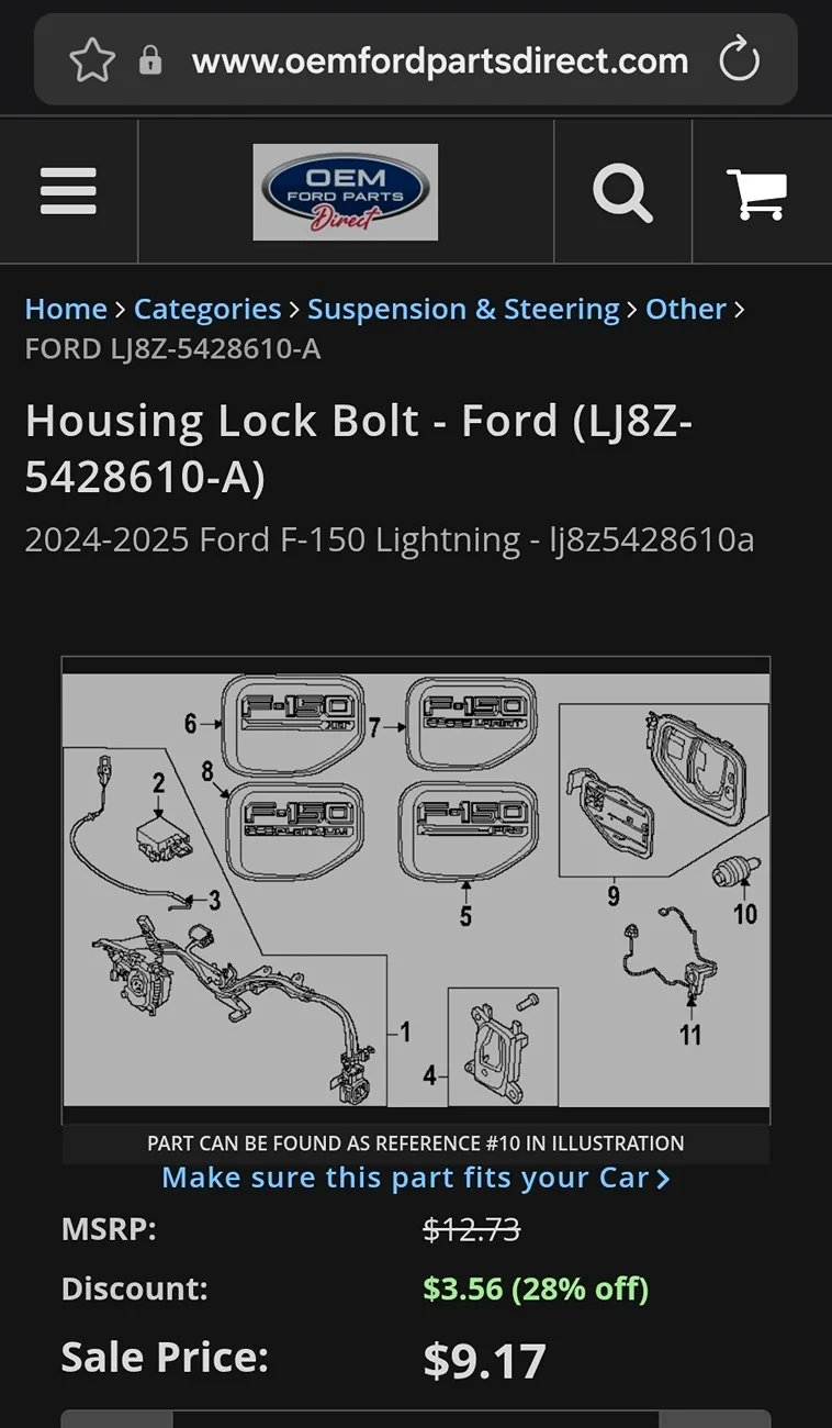

So 2 parts were replaced,
LJ8Z-5428610-A (release asy)
and
RL3Z-10D737-A (actuator asy)
Parts total was like $45.00

Thanks for the update. This is the charge door latch actuator. It looks like it is part of the charge port indicator and unlock button, so a failure must have disabled charging since you can't stop charging with the button on failure. I guess Ford considers the charge port door as part of the powertrain. The upside, it should have been a pretty simple fix.
