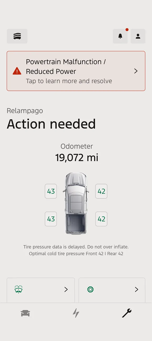

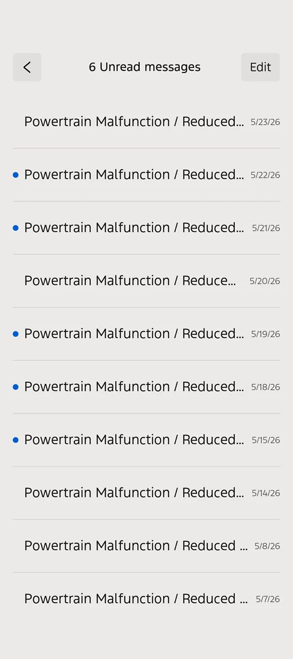

powertrain malfunction with 100% power - Code P0DE9
