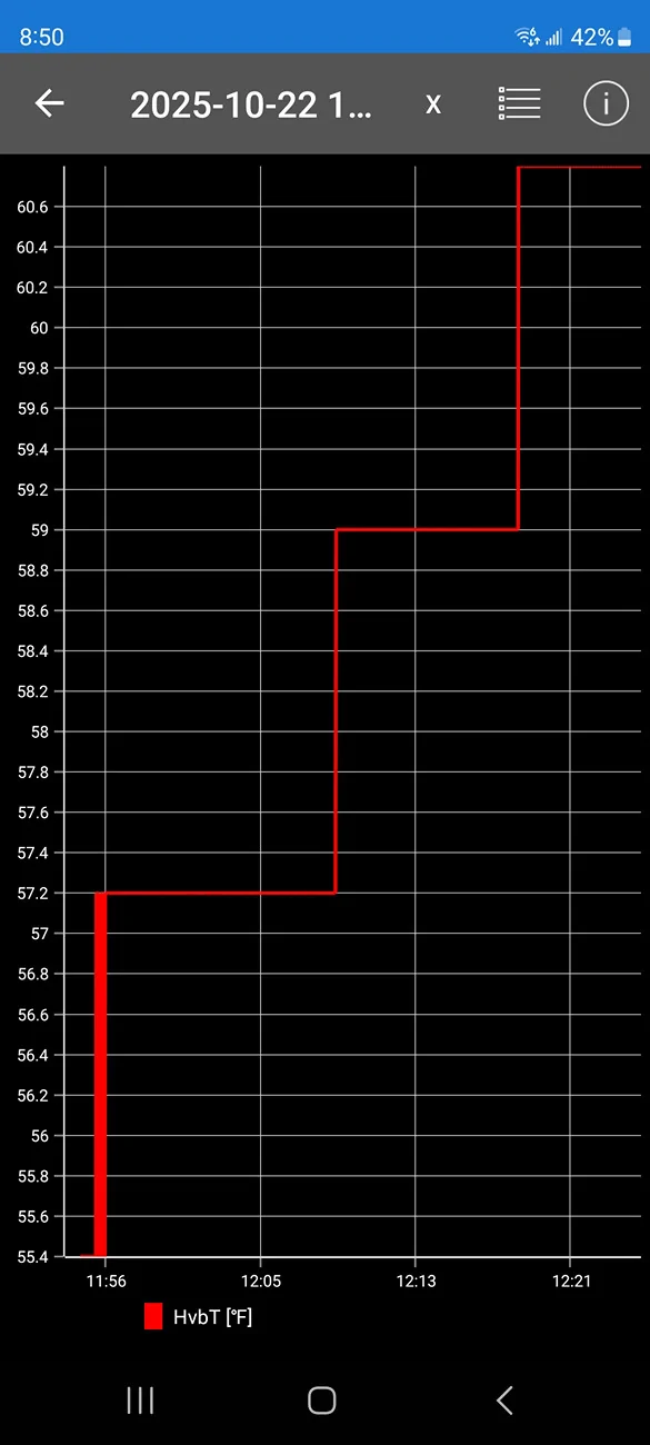

I didn't notice anything abnormal either. I am thinking when the battery is cold during charging, especially fast charging heating it up may reduce long term damage. Also during a drive with cold battery, I may not get as much energy out of it so heating it may give me more energy out than I put in warming it up. I don't have any data. Just guessing here. So if the valve can not help heating the battery properly when it is cold, damage may be more long term.
I recorded some data when I dropped it off. I may try to record some data after the fix in similar ambient and battery temp and see if battery heats up any faster. Here is the before data. It went up 5 degrees in 25 minutes driving 70+ mph.
